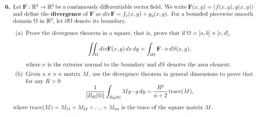

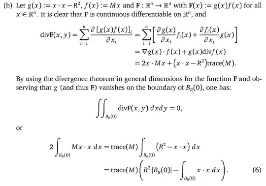

Here is the question I am trying to solve letter $(b)$ of it:

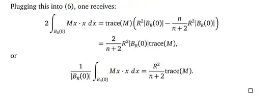

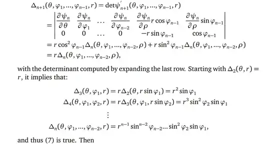

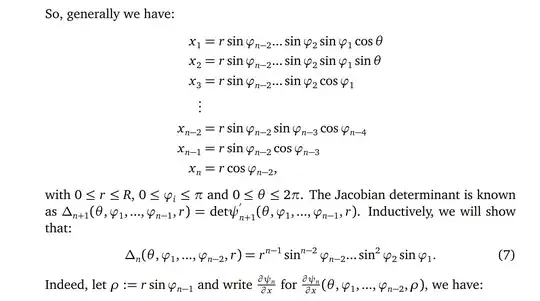

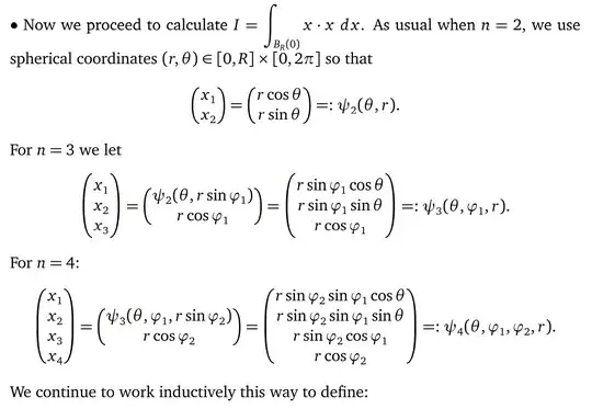

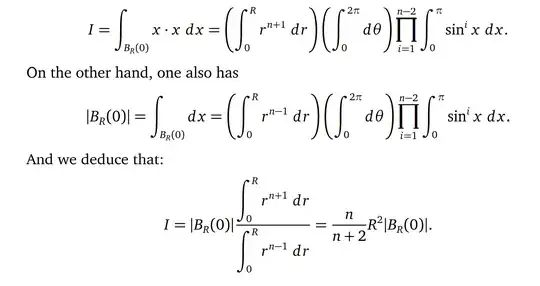

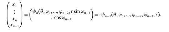

Here is a solution to it:
enter image description here enter image description here enter image description here enter image description here enter image description here enter image description here enter image description here
Which is a very very long solution. Does anyone have a more elegant and succinct solution please?
