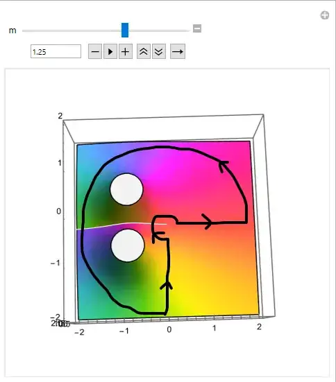

Here's the problem. When $1<m<1.5$, we have a contour similar to enter image description here
which not only crosses the branch cut twice, and encloses more than $1$ pole. This would obviously invalidate the residue that we get by assuming the contour encloses only $1$ pole.

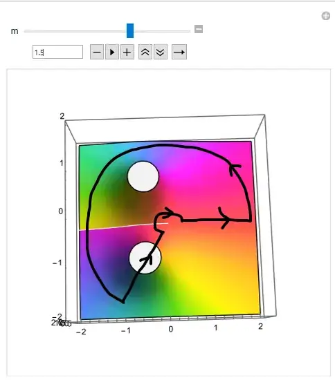

When we have $m=1.5$, we actually integrate through a pole
I'm presuming this wouldn't be much of a problem if we make a small detour around it. The small arc around the pole goes to $0$, and the path coming back to the origin can be thought of in a principal value sense. But we're still integrating past a branch cut.

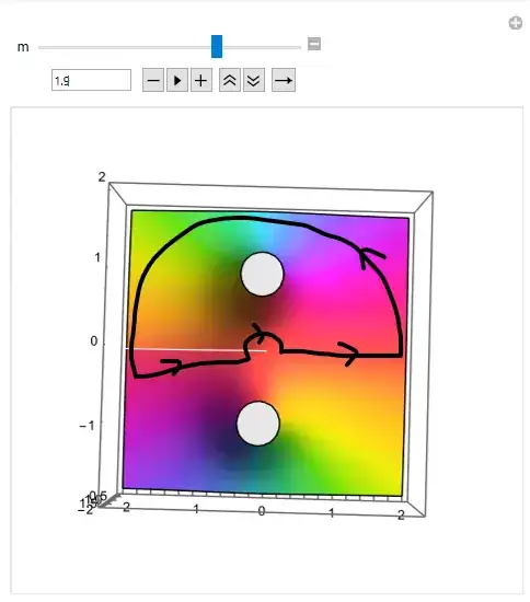

When $1.5<m<2$, we have a contour that looks like
which still crosses the branch cut twice!

Yes, I think you found a mistake in that linked answer: When $1<m<2$, we need to use a different branch cut of the complex function $z^m$.
The region of integration has $z = re^{i \theta}$ where $\epsilon \leq r \leq R$, $0 \leq \theta \leq \frac{2\pi}{m}$. So to get a function mostly continuous in the region, we can take the branch cut along the ray bisecting the remaining angle between $\frac{2\pi}{m}$ and $2\pi$: With $r, \theta \in \mathbb{R}$ and $r \geq 0$, this branch is given by
$$ (r e^{i\theta})^m = r^m \exp\left(i m \theta - 2im\pi \left\lfloor \frac{\theta}{2\pi} + \frac{m-1}{2m} \right\rfloor\right) $$
Using this meaning of $z^m$, the integrand $f(z) = \frac{z^n}{1+z^m}$ has exactly one pole inside the region of integration, at $z=e^{i \pi/m}$.
For example, suppose $m = \frac{4}{3}$. The region has $0 \leq \theta \leq \frac{3\pi}{2}$, and $f$'s only pole is at $z=e^{3i \pi/4}$. Although some branches of $z^{4/3}$, including the principal branch, have a pole at $z = e^{-3i \pi/4}$, this function $f$ does not: it's defined in terms of a "$z^{4/3}$" branch which gives $e^{-3i\pi/4} \mapsto \exp(\frac{4}{3} \frac{5i \pi}{4}) = e^{-i \pi/3}$ so there is no division by zero.
We also see that along the straight line segment edges of the path of integration where $\theta = 0$ or $\theta = \frac{2\pi}{m}$ ($\Gamma_1$ and $\Gamma_3$ in the linked answer), the chosen branch gives $z^m = 1$, so $f(z) = \frac{z^n}{2}$, and the symmetry argument is allowed. ($f(z)$ has different values on $\Gamma_3$ if the principal branch of $z^m$ is used with $m<2$.)
