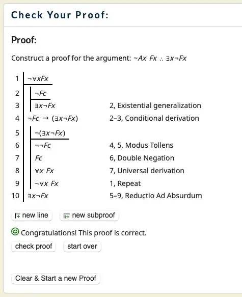

This is what I did a few days ago, when I was playing with the proof checker and wanted to understand how universal derivation works in that tool.
$$\begin{array}{|rll} 1 & \neg\forall x\ Px\\ \hline &\rlap{\begin{array}{|rll} 2 & \neg Pa\\ \hline 3 & \exists y\ \neg Py & \text{2, Existential generalization} \end{array}}\\ 4 & \neg Pa \to (\exists y\ \neg Py) & \text{2-3, Conditional derivation}\\ &\rlap{\begin{array}{|rll} 5 & \neg(\exists y\ \neg Py)\\ \hline 6 & \neg \neg Pa & \text{4, 5, Modus Tollens}\\ 7 & Pa & \text{6, Double Negation}\\ 8 & \forall x\ Px & \text{7, Universal derivation}\\ 9 & \neg \forall x \ Px & \text{1, Repeat}\\ \end{array}}\\ 10 & \exists y \ \neg Py & \text{5-9, Reductio Ad Absurdum} \end{array}$$
Here is an image of the same proof with better aligned reasons. But I was using different variable names a few days ago.
