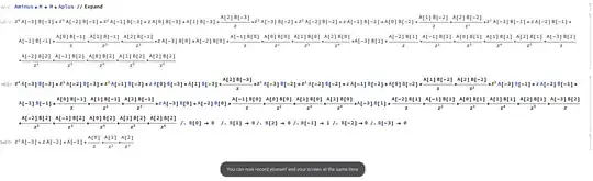

Mathematica code to test show this is below:
 Aplus:=Sum[A[n]*z^(-n-1),{n,-3,-1}]
Aminus:=Sum[A[n]*z^(-n-1),{n,0,2}]
Bplus:=Sum[B[n]*z^(-n-1),{n,-3,-1}]
Bminus:=Sum[B[n]*z^(-n-1),{n,0,2}]
M:= Sum[B[n]*z^(-n-1),{n,-3,2}]
AminusM + MAplus //Expand
Then I did this to the result
image of mathematica code
This means
/. B[0] -> 0    /. B[1] -> 0/. B[2] -> 0 /.B[-1] -> 1 /. B[-2]->0
/.B[-3] -> 0 specifies the identity field.
