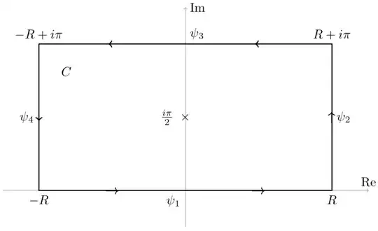

Contour used To elaborate on @FShrike’s approach, we can use a rectangular contour as shown to evaluate the first integral. The same method does not work on the second since the integral cancels out and we are left with $0$.
Define $$f(z)=\csc \left(\frac{\pi+2iz}{2\sqrt{2}}\right)\operatorname{sech}^2 (z)$$ There is a third-order pole at $z=\frac{i\pi}{2}$ enclosed by the contour so by Cauchy’s residue theorem \begin{align}\oint_{C} f(z)\,dz&=2\pi i \operatorname{Res}\left[f(z),\,z=\frac{i\pi}{2}\right]\\&=2\pi i\cdot\frac{1}{2}\lim_{z\to \frac{i\pi}{2}} \frac{d^2}{dz^2} \left(\left(z-\frac{i\pi}{2}\right)^3 f(z)\right)\\&=2\pi i \cdot \frac{-5i}{6\sqrt{2}}=\frac{5\pi}{3\sqrt{2}}\\&=\int_{\psi_1}+\int_{\psi_2}+\int_{\psi_3} + \int_{\psi_4}\end{align}
We parametrise over $\psi_3$ by setting $z=t+i\pi \implies dz=dt$ giving $$\int_{\psi_3} f(z)\,dz =\int_{R}^{-R} -\csc \left(\frac{\pi-2it}{2\sqrt{2}}\right)\operatorname{sech}^2 (t)\,dt\stackrel{t\mapsto -x}{=}\int_{-R}^{R} \csc \left(\frac{\pi+2ix}{2\sqrt{2}}\right)\operatorname{sech}^2 (x)\,dx=\int_{\psi_1} f(x)\,dx$$
As $R \to \infty$ it can be shown that the integrals over $\psi_2$ and $\psi_4$ go to $0$, so $$2\int_{-\infty}^{\infty} \csc \left(\frac{\pi+2ix}{2\sqrt{2}}\right)\operatorname{sech}^2 (x)\,dx=\frac{5\pi}{3\sqrt{2}}$$
So $$I_1=\frac{5\pi}{6\sqrt{2}}$$ as desired. $\square$

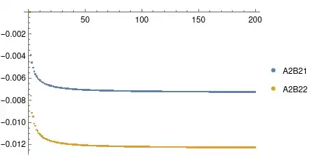

To solve $int_2$, I tried the following using Mittag-Lefflers' theorem and the corresponding expansions of $\csc(x)$ and $\text{sech}^2(x)$ given by $$ \text{csc}(x) = \underbrace{\frac{1}{x}}_{A_1} + \underbrace{2 x \sum_{k=1}^\infty \frac{(-1)^k}{x^2 - (\pi k)^2}}_{A_2}, \forall \frac{x}{\pi} \notin \mathbb{Z} \\ \text{with } \ x = \frac{\pi + 2 i z}{2 \sqrt{2}} $$ and $$ \text{sech}^2(z)= \underbrace{\frac{8 (\pi^2 - 4 z^2}{(\pi^2 + 4 z^2)^2}}_{B_1} - \overbrace{\sum_{k=1}^{\infty} \frac{1}{\left( z - (k+\frac{1}{2}) i \pi \right)^2}}^{B_{21}} - \overbrace{\sum_{k=1}^{\infty} \frac{1}{\left( z + (k+\frac{1}{2}) i \pi \right)^2}}^{B_{22}}, \forall \frac{i z}{\pi} \pm \frac{1}{2} \notin \mathbb{Z} \ . $$ Applying those to the problem, the integrand of $int_2$ now consists of 5 contributions: $$ int_2 = I_2 = \int_{-\infty}^\infty \frac{A_1 B_1 - A_1 B_2 + B_1 A_2 - A_2 B_{21} - A_2 B_{22}}{\pi+2 iz} \,dz \ . $$ Using Cauchy's product formula $\left( \sum_{i=1}^{\infty} a_i \right)\left( \sum_{j=1}^{\infty} b_j \right) = \sum_{k \geq 1} \sum_{l=1}^k a_l b_{k+1-l}$, I get for the addends $A_2 B_{2i}$ (summation is now from $k: 1 \to \infty$ (first sum) and $l: 1\to k$ (second sum)) $$ A_2 B_{21} = \frac{(-1)^l}{\left(-\pi ^2 l^2+\frac{1}{8} (\pi +2 i z)^2\right) \left(z-i \pi \left(k-l+\frac{3}{2}\right)\right)^2} $$ and $$ A_2 B_{22} = \frac{(-1)^l}{\left(-\pi ^2 l^2+\frac{1}{8} (\pi +2 i z)^2\right) \left(z+i \pi \left(k-l+\frac{3}{2}\right)\right)^2} \ . $$ Swapping the order of summation and integration and performing the integrals, I get the results $$ \text{int}(A_1 B_1) = \frac{2 \sqrt{2}}{\pi ^2} \ ,\\ \text{int}(A_1 B_2) = -\frac{2 \sqrt{2}}{\pi ^2 (k+1)^3} \ ,\\ \text{int}(B_1 A_2) = -\frac{(-1)^k \left(4 k^2+2 \sqrt{2} k+1\right)}{2 k^3 \left(\pi \sqrt{2} k+\pi \right)^2} \ ,\\ \text{int}(A_2 B_{21}) = \frac{(-1)^l}{2 \pi ^3 l^2 \left(2 \left(\sqrt{2}-1\right) (k+1) l+(k+1)^2+\left(3-2 \sqrt{2}\right) l^2\right)} \text{and}\\ \text{int}(A_2 B_{22}) = \frac{(-1)^l \left(\frac{2}{(k-l+2)^2}-\frac{1}{\left(k+\left(\sqrt{2}-1\right) l+2\right)^2}\right)}{2 \pi ^3 l^2} \ . $$ Performing the sums, I get (using Lerch $\Phi$-function and Riemann $\zeta$ function) $$ \sum_{k=1}^\infty \text{int}(A_1 B_2) = -\frac{2 \sqrt{2} (\zeta (3)-1)}{\pi ^2} \ \text{and} \\ \sum_{k=1}^\infty \text{int}(B_1 A_2) = \frac{-8 \Phi \left(-1,1,1+\frac{1}{\sqrt{2}}\right)+3 \zeta (3)-\sqrt{2} \zeta \left(2,\frac{1}{4} \left(\sqrt{2}+2\right)\right)+\sqrt{2} \zeta \left(2,\frac{1}{4} \left(\sqrt{2}+4\right)\right)+\log (256)}{8 \pi ^2} \ . $$ For the last two terms in the integral $$ \sum_{k=1}^{\infty} \sum_{l=1}^k \text{int}(A_2 B_{21}) \quad \text{and} \quad \sum_{k=1}^{\infty} \sum_{l=1}^k \text{int}(A_2 B_{22}) $$ I don't find those nice solutions... Plotting two double series' $\sum_k^{k_{max}}\sum_{l}^k$ for $1 \leq k \leq k_{max} = 200$ however, one could get the intuition, that the expressions converge to something (see figure below) - Does anyone have an idea of how to find the corresponding expressions and do you think that this approach is correct? enter image description here
