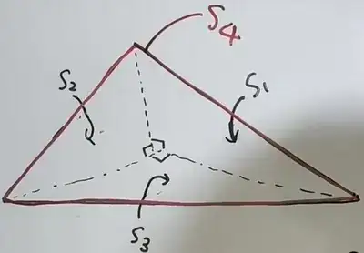

I should have depicted the following tetrahedron using tikz of tex. The image below is from this instagram post
$$ \color{fuchsia}{\underbrace{S_4^2= S_1^2+S_2^2+S_3^2}_{\text{I want to derive this} } } $$
$~ S_i ~$ represents the ith area of a triangle.
What I've done for deriving it are as follows.
$$\begin{cases} (0,0,0) \leftarrow~~\text{coordinates where the 3 right angle symbols gather}\\ (a,0,0) \leftarrow~~\text{coordinates on x-axis}\\ (0,b,0) \leftarrow~~\text{coordinates on y-axis}\\ (0,0,c) \leftarrow~~\text{coordinates on z-axis}\\ \end{cases}$$
Please assume that x-axis is along with left and y-axis is along with right and z-axis with vertical.
$$\begin{cases} S_1={1 \over 2 }bc\\ S_2={1 \over 2 }ac\\ S_3={1 \over 2 }ab\\ \end{cases}$$
So the remaining problem is to find out the formula of $~ S_4 ~$
What I've thought for it is to firstly find out the perpendicular line between $~ \text{AB} ~$ and $~ \text{C} ~$.
If that is done, then the coordinates on $~\text{AB} ~$ which is passed by that perpendicular line is known(we define this position as $~ \text{D} ~$ )
Hence
$$ S_4={1 \over 2 } \left( \text{AD} \cdot \text{CD} + \text{BD} \cdot \text{CD} \right) $$
But this way seems a bit complicated one I think.
Is there some more simpler way to derive the area of $~ S_4 ~$ ?
In the first place I don't know how to find the perpendicular line...
