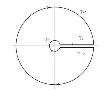

We shall use the residue theorem to compute. Consider the keyhole contour, enter image description here
and put $f(z)=\frac{\log^2(z)}{1+z^3}$. It is easy to estimate that the integral on the big circle and the small circle vanishes when $R\to\infty$ and $r\to 0$. Compute the residue at $z=e^{\frac{\pi i}{3}},e^{\pi i},e^{\frac{5 \pi i}{3}}$ and the sum of these residues is $\frac{4}{27} \left(1-3 i \sqrt{3}\right) \pi ^2$. According to the former discussion,
$$2\pi i\cdot \frac{4}{27} \left(1-3 i \sqrt{3}\right) \pi ^2=-4\pi i\int^\infty_0\frac{\log x}{1+x^3}\mathrm{d}x+4\pi^2\int^\infty_0\frac{\mathrm{d}{x}}{1+x^3}.$$ Hence $$ \int^\infty_0\frac{\log x}{1+x^3}\mathrm{d}x=-\frac{2 \pi ^2}{27}$$

  • Hi, I've never seen the keyhole contour method and I am having trouble with understanding it. Why do the $\gamma_\varepsilon$ and the $\gamma_{-\varepsilon}$ not cancel out? – Giordano Crimi Aug 01 '22 at 13:07
  • @johncrimes That is because the angle of $z$ on $\gamma_{-\epsilon}$ is $2\pi i$, so the integral on $\gamma_{-\epsilon}$ is actually $\int (\log z+2\pi i)^2/(1+z^3)\mathrm{d}z$. – Zhang Aug 01 '22 at 13:13
  • @johncrimes $\log$ is a multivalued function, so you need to fix a branch, in respect of which you compute. – Zhang Aug 01 '22 at 13:15
