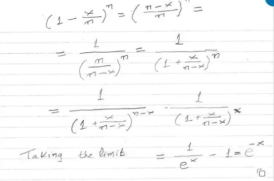

Clearly $e=\displaystyle \lim_{n \to+\infty}(1+\dfrac{1}{n})^{n}$.
Now consider $(1+\dfrac{x}{n})^{n}$. This can be written as $(1+\dfrac{1}{\frac{n}{x}})^{n}$ which is equal to
$[(1+\dfrac{1}{\frac{n}{x}})^\frac{n}{x}]^{x}$. Clearly the limit of the brackets is $e$, hence the limit is $e^{x}$. Setting $x=-1$ we get the required equality! i.e.
$\displaystyle \lim_{ x\to +\infty}(1-\dfrac{1}{x})^{x}=e^{-1}$.
As an answer to a comment I give a very simple proof that $\displaystyle \lim_{ n\to+\infty}(1+\dfrac{x}{n})^{n}=e^{x}$ for ALL $x$ positive, negative or zero! Let $x>0$. Then, (sorry for not typing)
  • When you set $x=-1$ and take the limit of $n\to\infty$, basically it is computing $\lim_{x\to -\infty} (1 + 1/x)^x$. My question is, by defining $e = \lim_{x\to \infty} (1 + 1/x)^x$, how can I prove that $e=\lim_{x\to -\infty} (1 + 1/x)^x$? – keepfrog Jul 28 '22 at 07:46
    Read my answer carefully! I prove that assuming $e=\displaystyle \lim_{x \to+\infty}(1+\dfrac{1}{x})^{x}$ we get $\displaystyle \lim_{n \to+\infty}(1+\dfrac{x}{n})^{n}=e^{x} $. Then setting $x=-1$ we get the result! I just use n instead of $x$. The limit (when $x\to +\infty$) is the same for all sequences tending to $+\infty$ and hence for $x_{n}=n$. –  Jul 28 '22 at 12:46
  • But, when $x<0$, "Clearly the limit of the brackets is $e$" is not obvious, because $e = \lim_{n\to-\infty} (1 + 1/n)^n$ is not proven yet. If $x>0$, then it immediately follows from the definition, but if $x<0$, that requires proving $e = \lim_{n\to-\infty} (1 + 1/n)^n$ – keepfrog Jul 29 '22 at 21:46
    Read my picture edit to see what happens. It has nothing to do with $x$ being positive,negative or zero!! –  Jul 30 '22 at 00:10
  • Thanks, this is the proof that I was looking for. – keepfrog Jul 30 '22 at 21:19
