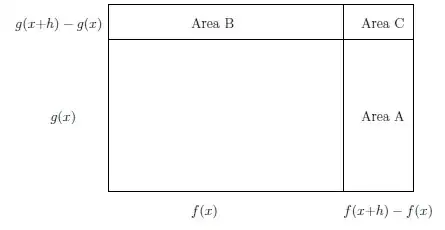

I also came across what seems to be a useful pic to understand the rule
(pp 2 http://aleph0.clarku.edu/~djoyce/ma120/derivatives2.pdf)
but when it comes to adding and subtract $f(x+h)g(x)$, I don't see the point of doing it.
geometical interpretation

If you want a proof that follows the picture more closely, you could start with \begin{equation} f(x+h)g(x+h) = f(x)g(x) + (f(x+h)-f(x))g(x) + (g(x+h)-g(x))f(x) + (f(x+h)-f(x))(g(x+h)-g(x)). \end{equation}
Now bring $f(x)g(x)$ to the other side, divide by $h$, and take the limit as $h\to 0$.

The point of adding and subtracting $f(x+h)g(x)$ is to get two terms that we can use the distributive law with. We have $$f(x+h)g(x+h)=f(x+h)g(x+h)-f(x+h)g(x)+f(x+h)g(x)-f(x)g(x)\\ =f(x+h)[g(x+h)-g(x)]+g(x)[f(x+h)-f(x)]$$ The two terms in square brackets are ones in the definition of $g'(x)$ and $f'(x)$. In your figure, the first term in the last line is Area B and the second term in the last line is Area A. We then argue that Area C is small enough we can ignore it as it has a factor of $h$ in each dimension.

In terms of the picture, the goal is to find another way to express the sum of the areas of $A$, $B$, and $C$. You could express it as the area of the whole rectangle minus the largest rectangle (i.e., $f(x+h)g(x+h)-f(x)g(x)$),
or you could express it as the area of $B$ and $C$ (i.e., $f(x+h)g(x+h) - f(x+h)g(x)$) added with the area of $A$ (i.e., $f(x+h)g(x)-f(x)g(x)$). The reason for doing this, though, is what I stated above: to make the proof work and to get the desired result.
