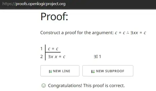

  • Open Logic Project does not use Suppes' system. OLP uses introduction rule: "Thus, inferring ∃x P (t, x) from P (t, t) is a correct application of ∃Intro—you may “replace” one or more, and not necessarily all, occurrences of t in the premise by the bound variable x" – Tankut Beygu Jul 21 '22 at 18:18

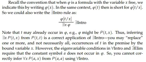

This is the definition of the definition of existential introduction rule from the text of Open Logic Project (p. 276):
So, Suppes' definition is wrong and Open Logic Project's is right? No, neither one is wrong; if one gives the same input, one gets the same output from both of them, the difference resides in between. They are just different systems of proof that serve the same ends, each with its vices and virtues. A necessity is that one ought to absolutely keep in the system one has begun with all the way through, even if an obvious line appears counter-intuitively hard to derive.

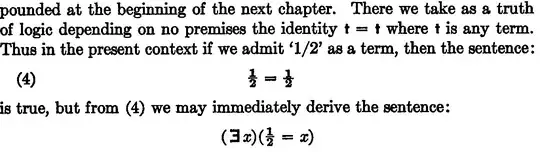

    @AlexKruckman Take notice that I do not say $\exists x(x = t)$ is not derivable. I say: 1. The rule is correctly stated, 2. From $1 = 1$ one cannot derive $\exists x(x = 1)$ by existential generalisation. So: what the OP tries to do is wrongheaded, what the OP sees obliged to do is the proper derivation according to the rule of EG. – Tankut Beygu Jul 21 '22 at 13:27
  • Notice on page 78 (Before EG is introduced) the author derives $\exists x(x = \frac{1}{2}$ from $\frac{1}{2}= \frac{1}{2}$ so the author is being inconsistent then also, which actually led me to the question. From your above comment and post Suppes also makes the same mistake using his formation of EG – JCAL Jul 21 '22 at 21:31
