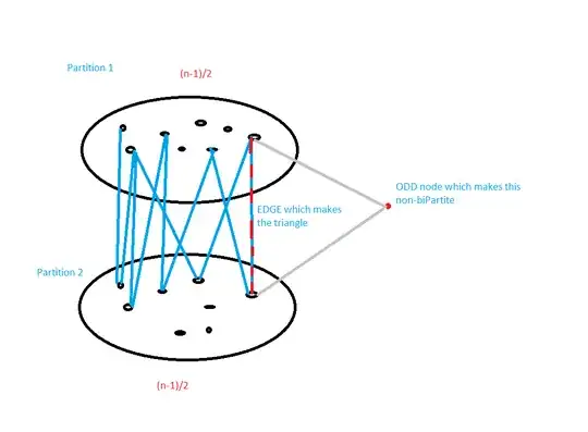

Pictorial Visualization

  • I believe that something is wrong with that reasoning. – RFZ Jul 19 '22 at 17:32
  • With n=5 , I can make Partitions with 2+2 having 4 edges & 2 edges from the last node , & remove 1 edge to get 5 edges total. With n=15 , I can make Partitions with 7+7 having 49 edges & 2 edges from the last node , & remove 1 edge to get 50 edges total. Calculation works out !! – Prem Jul 19 '22 at 17:44
  • "A graph becomes non-bipartite when even 1 node makes bipartition impossible. " - It does not make sense. – RFZ Jul 19 '22 at 17:48
  • It will make sense if you look at the attached Picture !! – Prem Jul 19 '22 at 17:49
  • It does not make sense at all. First of all, what do you mean by Odd node? If you erase one vertex from graph the remaining graph can be still non-bipartite. – RFZ Jul 19 '22 at 18:09
  • I have addressed the "Doubts" in your comments in the latest edit to my Answer !! – Prem Jul 19 '22 at 19:55
  • Even your addendum is written very poorly and without any justification. Even the definition of bipartite graph you wrote incorrectly... – RFZ Jul 19 '22 at 20:34
  • (A) You should include your Definitions of BiPartite & Non-BiPartite ; I have not included the Definitions , I have only "Intuitively" stated ( & used ) the Properties of BiPartite & Non-BiPartite ; (B) Check the Duplicate Question & the Answer by user "hardmath" , 1 year ago ; the last Paragraph is my Exact Same Intuitive Argument !! which is : remove 1 edge , add 1 node , add 2 edges , making it Non-BiPartite with no triangles !! – Prem Jul 20 '22 at 04:19
