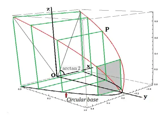

There are many possibilities. Take a look at a solid carved out of a unit sphere as a particular case.
When two planes $\dfrac{z}{x}=2$ intersect a sphere radius $\sqrt 5 $ we have two red great circle intersections and all sections normal to y-axis between these intersection great circles are squares.
The squares stand over $xOy$ plane parallel with an edge on this plane being parallel to $xOz$ plane between ellipse projections as shown in a 3d hand sketch below. Since square discs are stacked integration should proceed with resp to $y$ axis, with elemental volumes obtained by integration with $dy$.
Parameterization of the spheres radius $\sqrt 5$ centered at origin:
$$P(x,y,z)= (\pm t ,\sqrt5 \sqrt{1-t^2}, 2t ) $$
$$ y= \sqrt5 \sqrt{1-t^2} ; dy =\frac{\sqrt5 t dt}{\sqrt{1-t^2}} $$
$$ dV= 4 t^2. dy =4 t^2\frac{\sqrt5 t dt}{\sqrt{1-t^2}}$$ $$ V = 4 {\sqrt5 }\int _0^1\; t^3 {\sqrt{1-t^2}} dt; \; $$
Hope you can take it from here ( substitution $t^2=u$) scaling radius from $\sqrt5$ to 9 by cubing this ratio for volume multiplication and then doubling it for the $-y$ part of the solid.
