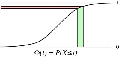

Suppose a random variable $X$ has the Cumulative Distribution Function $\Phi(t)=P(X\le t)$:
$\hspace{3.2cm}$enter image description here
The probability of $X$ being within the base of the green region, is the height of the red region. Thus, $\Phi(X)$ is uniformly distributed along the vertical axis, $[0,1]$. Therefore, $\Phi^{-1}(U)$ has the same distribution as $X$ where $U$ is uniformly distributed in $[0,1]$.
As long as the region is radial, the CDF of being within $t$ of the origin is $$ \Phi(t)=\frac{t^3}{r^3} $$ Thus, we get the proper distribution of the distance from the origin with $$ r\,u^{1/3}\tag{1} $$ where $u$ is uniform in $[0,1]$.

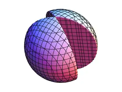

If the region is supposed to look like this between polar angles $\phi_{\text{min}}$ and $\phi_{\text{max}}$:
$\hspace{3.2cm}$
Then we would take $$ \begin{align} z&=\cos(\phi_{\text{max}})+(\cos(\phi_{\text{min}})-\cos(\phi_{\text{max}}))v\\ y&=\sin(2\pi w)\sqrt{1-z^2}\\ x&=\cos(2\pi w)\sqrt{1-z^2} \end{align}\tag{3} $$ where $v$ and $w$ are uniform in $[0,1]$.
To get the points in the sphere, multiply the points on the sphere from $(3)$ by the radius from $(2)$.

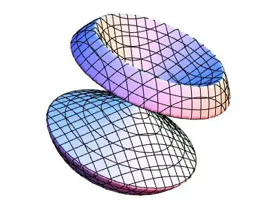

If the region is supposed to look like this between equatorial angles $\phi_{\text{min}}$ and $\phi_{\text{max}}$:
$\hspace{3.2cm}$
Then we would take $$ \begin{align} z&=2v-1\\ y&=\sin(\phi_{\text{min}}+(\phi_{\text{max}}-\phi_{\text{min}})w)\sqrt{1-z^2}\\ x&=\cos(\phi_{\text{min}}+(\phi_{\text{max}}-\phi_{\text{min}})w)\sqrt{1-z^2} \end{align}\tag{4} $$ where $v$ and $w$ are uniform in $[0,1]$.
To get the points in the sphere, multiply the points on the sphere from $(4)$ by the radius from $(2)$.

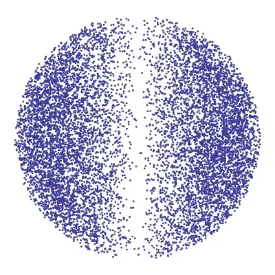

10000 Points: Generated using $(2)$ and $(3)$ (top is approaching; bottom is receding)
$\hspace{3.5cm}$enter image description here

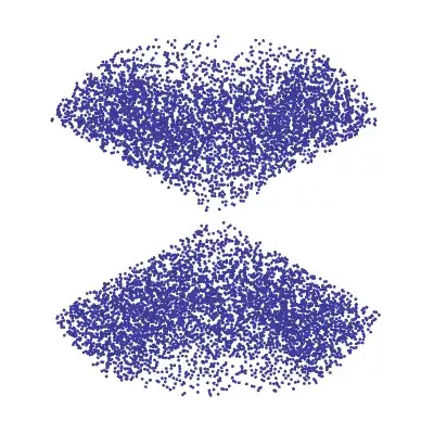

10000 Points: Generated using $(2)$ and $(4)$ (top is approaching; bottom is receding)

  • Yes.. exactly the lower plot and using the equation I mentioned also... thanks...but the your θ is not correct. – user87267 Jul 23 '13 at 16:59
  • @user87267: I actually used your equations and $(5)$ and got the same distribution as above. Why do you say that it is wrong? – robjohn Jul 23 '13 at 17:04
  • because I am getting half of the plot as in your r,θ,ϕ coordinate you wrote θ=sin−1(2v−1) which is going to -pi/2 to pi/2 but it should go between -pi to pi( or 0 to 2pi). I just want to know correct r, θ, ϕ. and also if you show the number of point in XY plane. They are not equally distributed but if r=rmax*sqrt(random(N)) then in XY (Z=0)plane number points (which shows a circle) are equally distributed. – user87267 Jul 23 '13 at 21:08
  • @user87267: That is why $r=r_{\text{max}}(2u-1)^{1/3}$ ranges over $[-r_{\text{max}},r_{\text{max}}]$; so that we get the other half filled in. Unfortunately, $\sin^{-1}(x)$ only has a range of half a full circle. Effectively, my formulas generate angles between $\frac\pi2$ and $\frac{3\pi}{2}$ when $2u-1\lt0$. – robjohn Jul 23 '13 at 21:37
