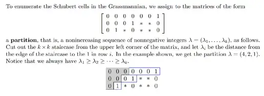

  • what is a n-cell structure : To begin with, anyway , if a Grassmannian is a really CW-complex, clearly the $n$-disk $D_{\alpha}^n$ exists. According to the M. Gillespie's paper, an open $n$-disk cell is correspondent to the Schubert cell, In order to explain what is a Schubert cell, the author explains a partition, $\lambda:=(\lambda_1,....,\lambda_n) $ a nonincreasing sequence of nonnegative integers
Then next, the author explains a Schubert cell, denoted by $\Omega_{\lambda}^{o}$, the set of points of $\operatorname{Gr}(n,k)$ whose row echelon matrix has corresponding partition $\lambda$. Next, the author calls the closure of Schubert cell , $\overline{\Omega_{\lambda}^{o}}:=\Omega_{\lambda} $, a Schubert variety. Schubert variety is likely correspondent to the closed ball. Frankly speaking, I am not sure why a Schubert cell analogously plays a role in an open $n$-disk. but I just believe the correspondence. Furthermore, the author explicitly express which element is a Schubert cell and Schubert variety.

$\Omega_{\lambda}^{o}= \left\{ V \in \operatorname{Gr}(n,k): \operatorname{dim}(V \cap <e_1,...e_r>)=i, for~ n-k+1-\lambda_{i} \le r \le n-k+1-\lambda_{i+1} \right\}$
$$\Omega_{\lambda} = \left\{ V \in \operatorname{Gr}(n,k): > \operatorname{dim}(V \cap <e_1,...e_{n-k+i-\lambda_{i}}>)\ge i \right\}(= \overline{\Omega_{\lambda}^{o}}) $$ where $e_1=(0,...,0,1), e_2=(0,...,0,1,0)$
