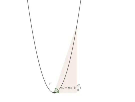

My attempt to phrase Brian Drake's answer even more simply:
The original problem can be phrased geometrically as, "What is the smallest angle $\theta$ by which we can rotate the standard parabola $P$ around the origin in order to make its rotated version $R$ intersect a given vertical test line $v$ at two points?"
There are two keys to solving the problem.
Key #1: In this problem, position is relative! The absolute positions of the rotated parabola $R$ and vertical line $v$ on the $xy$-plane do not change whether or not $R$ describes a function.
Key #2: Rotations are also always relative!
Let's now bring these two ideas together.
According to Key #1, we can choose the $y$-axis for our vertical line $v$. Why this choice? Some reasons:
  • Lines passing through the origin have an easily written function
  • The $y$-axis passes through the origin and so has an easy function
  • Standard parabola $P$ also passes through the origin
  • Rotated parabola $R$ was generated from rotating $P$ around the origin and so also passes through the origin
  • So, the $y$-axis passes through both $R$ and $P$
Then, the relativity of rotation from Key #2 mean it's completely OK to think of $\theta$ as a rotating $v$ around the origin while keeping the standard parabola $P$ fixed.
And I think that makes it obvious that any non-zero $\theta$ will make the point that any diagonal line passing through the origin will intersect the standard parabola at two points.
Of course, if you're not a visual/intuitive person, then you can formally justify this result in many ways.
  • 5xum does it above using rotations. He finds that $x_{intersection} = tan(\theta)$.
  • Brian Drake does it above by noting that a diagonal line passing through the origin will have an equation $y = mx$ for some slope $m$. He then finds the (other) intersection of this line with the standard parabola by setting $y_{intersection} = mx_{intersection} = x_{intersection}^2 \implies x_{intersection} = m$.
  • These two solutions are related by the fact that for all lines, $tan(\theta) = \frac{sin(\theta)}{cos(\theta)} = \frac{\Delta y}{\Delta x} = slope = m$.

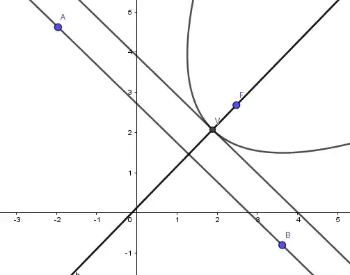

A part of the question is: how much do we have to rotate $y = x^2$ around the origin such that it hits the $y$-axis in a second point, in addition to the origin? To simplify this, instead of rotating the parabola (by $\varphi$) we can rotate the $y$-axis (by $-\varphi$). Now any non-vertical line through the origin has an equation $y=ax$ and $$x^2=ax$$ has a solution at $x=a$, so the line hits the parabola at $(a, a^2)$. We see that we cannot rotate the parabola even a tiny bit without losing the property that it is the graph of a function.
(In the above you may have noticed that I glossed over two cases: For $\varphi=\pi$ the $y$-axis is taken to itself, so it is vertical, and of course the parabola is mapped to $y=-x^2$, the graph of a function. And in the case $a=0$, corresponding to $\varphi=\pi/2$ or $\varphi=3\pi/2$, the point $(a,a^2)=(0,0)$ is the origin, so we would have to use a different line to show that the rotated parabola is not the graph of a function. But this is obvious.)

A rigid parabolic arc remains a parabola for any arbitrary displacement or rotation imparted to the parabolic arc.
That is why we can describe any parabola in the plane by an intrinsic or natural equation
$$ \kappa = \dfrac{\cos^3\phi}{2f} $$
where $\kappa$ is curvature and $ \phi $ the rotation of tangent reckoned from its vertex V and $f= VF, $ its focal length.
In rectangular coordinates with any constants $(a,b,c,d)$ we have two connected arcs of the same parabola separated by a tangent parallel to x-axis (not shown):
$$ y = ax+b \pm \sqrt{cx+d}.$$

$$\lim_{n\to\infty}{\alpha_n}=\frac{\pi}{2}$$ So we cannot rotate the graph of $y=x^2$ at all.
