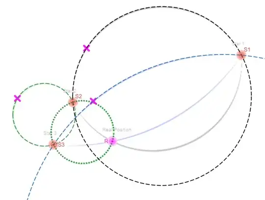

I have tried to reproduce your diagrams in Desmos. (The diagrams are interactive.)
The construction appears to be:
  • Given three fixed points (the stars)
  • Given a point (the ship)
  • Two stars and the ship determine a circle containing those three points. The angle between the displacement vectors from the ship to the two stars is constant for all ship positions on the arc containing the ship. (The other arc [which completes the circle] does not contain the ship.)
  • Two stars and the ship determine another circle containing those two stars and a point that is the ship reflected across the line joining the two stars. (The reflected-ship is the magenta X.) The angle between the displacement vectors from the reflected-ship to the two stars is the same constant for all positions on the arc containing the reflected-ship.
  • The three circles associated with the reflected-ships have a common intersection, which could lead to a degenerate point.
https://www.desmos.com/calculator/htw1bniiod
The three dashed circles associated with the reflected-ships intersect in the arcs that contains the reflected-ships.
robphy-desmos-htw1bniiod

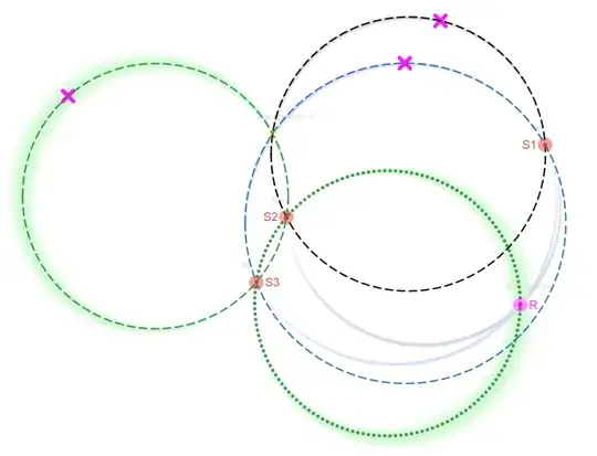

https://www.desmos.com/calculator/jxruewsve2
Here, the green dashed arc where the common intersection occurs does not contain the reflected-ship. (This might be a condition to test for.) Note that you can move the ship and obtain a degeneracy point like in the previous case. (Drag R to the lower right corner.) So, it's not just about the arrangement of the three stars.
robphy-desmos-jxruewsve2

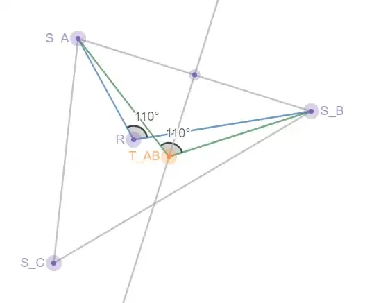

Now find a point on each bisector $T_{AB}$ such that the angle $S_A T_{AB} S_B$ is equal to $A_{AB}$ from our given coordinate. This is doable with some fairly basic trig.
visual showing a constructed point T_AB that has the same angle between S_A and S_B as R

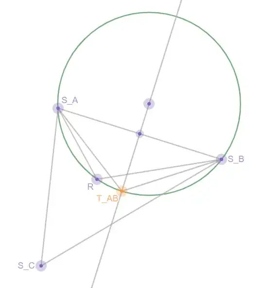

With that new point we construct a circle (an arc would also do) that passes through $S_A$, $T_{AB}$, and $S_B$. See Get the equation of a circle when given 3 points on how to construct said circle.
Circle passing through S_A, T_AB, S_B, and R

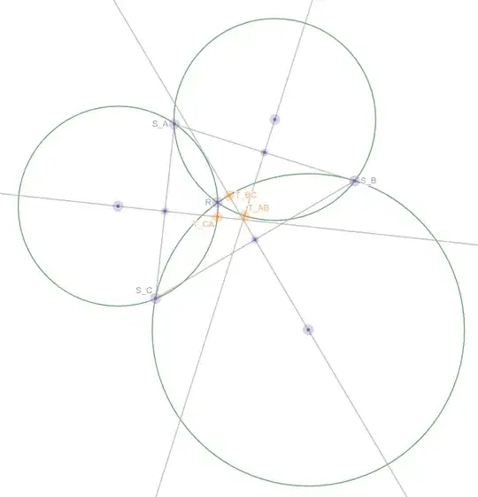

Repeat for all 3 pairs and you now have something like this
Circles passing through each pair of stars, and the points T_XY constructed from their perpendicular bisector
Since we enforced that the player be within the triangle formed by the stars, we have also guaranteed that there will be exactly one point at which the 3 circles intersect. I followed the answers on Find intersecting point of three circles programmatically to build a method that takes those 3 circles and finds their intersect. With a properly tuned epsilon, we can now find our ship!

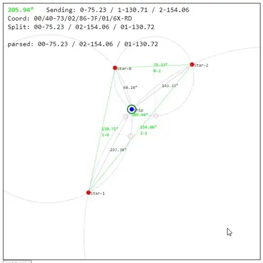

As a bonus here's a screen recording of the tool I built while I was working out this method:
GIF showing points S_A, S_B, S_C, and R being dragged around, and on-screen visuals telling us whether we can generate a coordinate for that arangement
