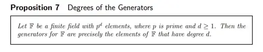

Proposition 7 goes: enter image description here
It seems to me there exists a counterexample to this statement:
  • The number of elements of order $p^k - 1$ in $\mathbb{F}_{p^k}$ (i.e. generators) is $$\varphi(p^k - 1)$$
  • The number of elements of degree $k$ is the number of irreducible polynomials of degree $k$ over $\mathbb{F}_p$ times $k$ (each yields polynomial yields $k$ unique algebraic numerbs of degree $k$), which is $$k \cdot \frac{1}{k}\sum\limits_{d \mid k} \ \mu(k/d) \cdot p^{d} = \sum\limits_{d \mid k} \ \mu(k/d) \cdot p^{d}$$
  • Taking $p = 2, k = 4$, we get: $$\varphi(2^4 - 1) = \varphi(15) = 2 * 4 = 8$$ $$ \sum\limits_{d \mid 4} \ \mu(4/d) \cdot 2^{d} = 2^1 * \mu(4) + 2^2 * \mu(2) + 2^4 * \mu(1) = 0 -4 + 16 = 12 $$
  • And indeed, $x^{16} - x$ factorizes over $\mathbb{F}_2$ as $x (x + 1) (x^2 + x + 1) (x^4 + x + 1) (x^4 + x^3 + 1) (x^4 + x^3 + x^2 + x + 1)$, containing 3 polynomials of degree 4, each of which yields 4 unique algebraic numbers [of degree 4].
  • Also, there is this python code which backs up this discrepancy.

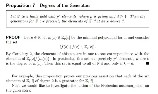

Let's take a look at the proof in the notes: ![enter image description here
It seems like this proof is incomplete: what implies that all the $[x]$, $[x^2]$, ..., $[x^{p^k - 1}]$ residues yield different results when applied to $a$?
Still, this looks fishy. Am I wrong? Is there a mistake in the counter-argument?
    It depends on what is meant by generator. $\mathbb F_p[a]=\mathbb F$ exactly when $a$ has order $d.$ The text seems to be using this as a definition of "generator" for a field, not for generator of the group of units. – Thomas Andrews Jul 13 '22 at 15:51
    You are correct using the group-theoretic usage of the word "generator," but the text seems to be using an algebraic definition of "generator." – Thomas Andrews Jul 13 '22 at 15:53
    I think if the author intended "generator" to mean a generator for the multiplicative group, they would say "a generator for $\Bbb F^\times$". – Greg Martin Jul 13 '22 at 15:56
    On page 4, which is before Proposition 7, the section Generators for Fields starts with "There is a notion of a generator for a field. This is similar to, but distinct from, the notion of a primitive element." A generator $a$ for a finite field $F$ is defined on page 4 to be a field generator: $F = \mathbf F_p(a)$. (He writes $\mathbf Z_p$ for the field of order $p$, but I prefer $\mathbf F_p$ since $\mathbf Z_p$ in number theory means the $p$-adic integers.) Jim uses "primitive element" of a finite field $F$ to mean a generator of $F^\times$ as a group: $F^\times = \langle a\rangle$. – KCd Jul 13 '22 at 19:36

The Proposition 7 is OK. Here are some comments.
The linked text gives a definition for a "generator" as follows:
Definition: Generator for a Field
Let $\Bbb F$ be a finite field of characteristic $p$. An element $a\in\Bbb F$ is called a generator for $\Bbb F$ if the set $$ \{\ f(a)\ | \ f(x) ∈ \Bbb Z_p[x]\ \} $$ is equal to $\Bbb F$.
So such a generator is a generator for $\Bbb F$ in its field structure. In other words, $a$ is a generator iff starting from $1$ and $a$ and using all field operations (plus, minus, times, divided by something non-zero) we get all elements of $\Bbb F$.
Your counterexample works with "generators" for the underlying group structure of the group of non-zero field elements. The operation being multiplication. Yes, this is a cyclic group of order $q:=p^k$, it is isomorphic to the additive group $(\Bbb Z/q,+)$ - which is generated by $1$ - and this and any other generator is relatively prime to $q$, when lifted to the integers. (Or use the ring structure that can be added to
$(\Bbb Z/q,+)$ in a natural way.)
Then the proof is complete. Assume that for two polynomials $f$ and $g$ with coefficients in the prime field (not only those in the list $1,x,x^2,...$) we have - when applied to $a\in\Bbb F$ - the relation $f(a)=f(g)$. Then $f-g$ is zero when applied on $a$, so the minimal polynomial $m$ of $a$ divides this difference. We have the same class in $\Bbb Z_p[x]/(m(x))$ for $f(x)$ and $g(x)$.
