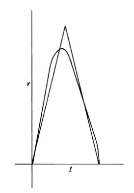

If we plot $v$ against $t$, the area under the curve must be the same (1 square unit) as that of an isosceles triangle having the same base and an altitude of 2. graph
The slopes of the sides of the triangle are $\pm 4$. Part of the $v-t$ curve must fall outside the triangle or coincide with its sides. Thus the slope, $a$, of the curve is $\geq 4$ at some point.

Note that for equality we would require the velocity function to not be differentiable at $0.5$, a case shown in the diagram posted by the OP which is a physical impossibility.
