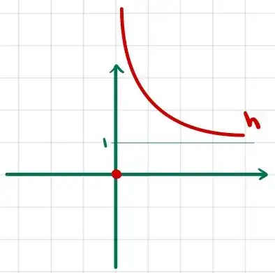

$$h(x)=\begin{cases} \frac{1}{2\sqrt{x}}+1, \text{ if } x \neq 0 \\ 0, \text{ if } x=0 \end{cases}$$
I believe $h$ looks something like
Is $h$ integrable? It is not bounded near $0$. In Spivak the definition of integrability is
A function $f$ which is bounded on $[a,b]$ is integrable on $[a,b]$ if $\sup\{L(f,P)\}=\inf\{U(f,P)\}=\int_a^b f$.
Note that if $l(x)=\sqrt{x}+x$ then $l'(x)=h(x)$. Thus, since $h$ is continuous on $(0,\infty)$ we can apply FTC2 and have
$$\int\limits_{x_0}^{x^2} h= l(x^2)-l(x_0)=x+x^2-\sqrt{x_0}-x_0$$
The issue is, what justifies allowing $x_0$ to be $0$, as the solution manual allows?

You are right: Spivak is inconsistent here. It's only later, near the end of the exercises from that chapter, that he defines a “kind of ‘improper integral’ in which the interval is bounded, but the function is not”.
