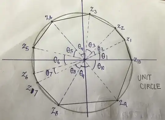

What I understand: $z$ is a unimodular complex number with argument $\theta_1$. The expression $z_k=z_{k-1}e^{i\theta_k}$ just indicates that rotating $z_{k-1}$ anticlockwise by $\theta_{k}$ gives $z_k$. Also, $\theta_1+\theta_2+ \theta_3+… + \theta_{10}=2\pi$ tells us that $z_{10}$ is the complex number $1+0\cdot i$. (X axis rotated on to itself). So I get a figure:
Now, statement P refers to just the perimeter of the polygon $z_1z_2…z_{10}z_1$, which is less than the circumference of the circle which is $2\pi$.
I have a problem with Q. My solution is to think that the $z_i^2$‘s are just all unimodular complex numbers with all the angles $\theta_i$ doubled. Thus the as we go from $z_1^2$ till $z_{10}^2$, we span the whole unit circle twice, ending at $z_{10}^2=1.$ So the total length of the sides of this (?? Double polygon?) is less than twice the circumference of the circle which is $4\pi$.
I’m a bit uncomfortable with the justification of Q. I think I can prove that the perimeter of a polygon is less than the circumference of its circumcircle (I haven’t attempted it yet)(#). This is a multiple choice question, so no extremely rigorous proofs are required.
Is it okay? How would you make the justification of Q rigorous? I’d also appreciate it if anyone could post an algebraic proof here.

For a different hint: $\;|z_2^2-z_1^2| = |z_2+z_1| \cdot |z_2 - z_1| \leq \left(|z_2| + |z_1|\right) \cdot |z_2-z_1| = 2\, |z_2-z_1|\,$.
Each side is smaller than the arc subtended, because the shortest distance between two points is the line segment between them.
