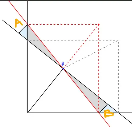

The drawings represent two attempts to produce the "immediate" solution. But neither approach seems to give a simple, and obvious formulation of $\delta\mathcal{A}$ that leads directly to the equation $\mathcal{A}=2ab.$

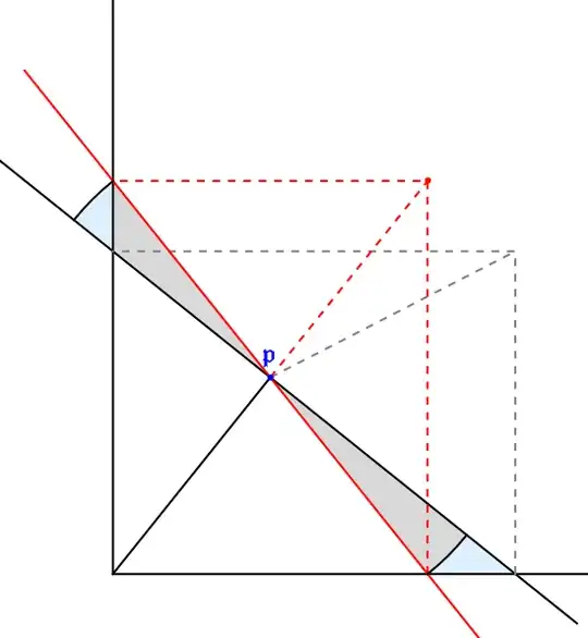

The red line is the correct solution. The black (or green) line is the result of rotating through $\delta\theta$. I've added another image with a greater difference between $a$ and $b$ to show more clearly that the light blue triangles are not equal.
How should the approach described in the "hints" be depicted?

Here is how I had done it, so I take your pic:
The situation is that no matter what size rotation we take, $\langle A = \langle B$. Now the next thing to notice is that as the red line $(a,b)$ about an infinitesimal angle (clockwise) , we lose area in sector spanned by $A$ and gain area in sector spanned by $B$. In the small angle limit, the contribution of blue parts to the total area of sector is zero, so the area of the blue triangular part is roughly zero.
This lets us wrote the differential area change as,
$$ dA =\frac{ r_1^2 d \theta - r_2^2 d \theta }{2}= \frac{\left(r_1^2 - r_2^2 \right) d \theta}{2}$$
Where $r_1$ and $r_2$ is distance from $p$ to the original x and y intercepts. If we want an the configuration to be such that area is maximum, nudging the parameter should leave the differential area zero upto first order in $\theta$, this can be achieved with the following equality:
$$r_1^2 = r_2^2$$
Which leads to $r_1=r_2$. This means distance from point to x intercept= distance from point to y intercept, this can be used to show that the coordinate of the intercept are same i.e: $(a,0) = (0,a)$.
Now use equation of area of right triangle for final answer.
  • I added another image to make clear that the two light blue triangles are not equal. – Steven Thomas Hatton Jun 27 '22 at 14:55
  • I didn't assume they are equal to do the proof @StevenThomasHatton Could you explain why you think I did, if you did? – Clemens Bartholdy Jun 27 '22 at 14:57
  • I thought you were canceling one blue area with the other. My problem with arguing that the blue area vanishes sufficiently fast is that $B$ becomes very large when $m$ approaches $0$. I could come up with an argument to get rid of it, but it would be more complicated than the magenta arcs appearing in my answer. And that drawing seems to illustrate Needham's hint. – Steven Thomas Hatton Jun 28 '22 at 03:38

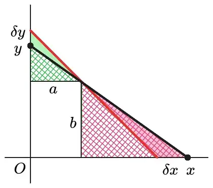

The way I did it is essentially seeing that there is a line touching a rectangle of size $ab$. Rotation of a line increases the area of the top triangle and must be equal to a decrease in the bottom triangle. So $\delta y\cdot a \asymp \delta x \cdot b$. Rearranging gives $$ \frac{\delta y}{\delta x}=\frac{b}{a} $$ which is eventually equal to the slope of the line. You immediately can see that by moving over $a$, we end up at the intersection, so the total area is $2ab$.
Area of top left triangle $\tfrac{1}{2}(y-b)a$, area of the square $ab$ and the right triangle $\tfrac{1}{2}(x-a)b$.
Now, if you modify the line (still touching the square corner), the $y$-intersect changes by $\delta y$ and the $x$-intersect changes by $\delta x$. Causing the area of the top left area to change to $\tfrac{1}{2}(y+\delta y -b)a$, the area of the square remains the same and the area of the right changes to $\tfrac{1}{2}(x-\delta x-a)b$. So the total change in area is $\tfrac{1}{2}(\delta y\cdot a - \delta x \cdot b)$.
In the minimum situation, this change must be zero; otherwise, we could decrease the area by either changing the line with this infinitesimal change or its reverse change. Hence, we must have $$ \delta y\cdot a=\delta x\cdot b. $$ and so we got $$ \frac{\delta y}{\delta x} = \frac{b}{a} $$ The infinitesimal change in area overall can also be written as $$ \delta A = \frac{1}{2} (x\delta y - y \delta x)=0, $$ leading to $$ \frac{y}{x} = \frac{\delta y}{\delta x} = \frac{b}{a}. $$ Together with the fact that it needs to pass through $(a,b)$ gives $y=2b$ and $x=2a$, giving an area of $2ab$.

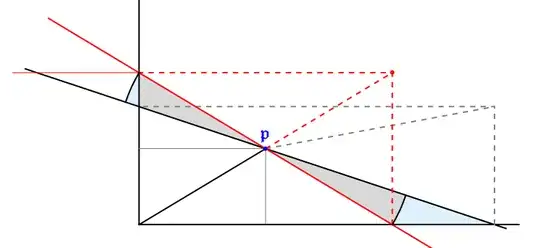

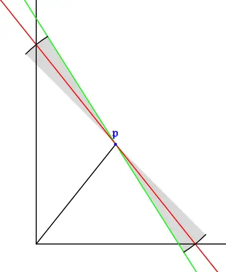

As others have pointed out. The problem amounts to showing that the fixed point is the midpoint between the intercepts along the solution line. Once that is established its a matter of trivial geometry to show $\mathcal{A}=2ab.$
The magenta circular arcs intersect the axes between the solution line and the varied line. The point of intersection is chosen to make the sector areas exactly equal to the corresponding variation triangles. The points of intersection determine the associated radii. These sector areas need to be ultimately equal in order to have a stationary value of $\theta$. Since the points of intersection along each axis converge as $\delta\theta$ goes to $0,$ the distance from $\left(a,b\right)$ to the points of intersection must become equal.
Both $\delta r_{x}$ and $\delta r_{y}$ are positive numbers. We now have:
\begin{align*} \delta\mathcal{A}= & \frac{1}{2}\left(\left(r+\delta r_{x}\right)^{2}-\left(r-\delta r_{y}\right)^{2}\right)\delta\theta\\ = & r\left(\delta r_{x}+\delta r_{y}\right)\delta\theta. \end{align*}
Needham actually introduces a standard of proof which he calls "beyond a reasonable doubt." I will have to invoke this, since the vanishing of $\delta\theta$ is sufficient for $\delta\mathcal{A}$ to vanish. Nonetheless, it is evident that $\left(\delta r_{x}+\delta r_{y}\right)$ must also vanish with $\delta\theta.$ But I can only wave my hands, and say it does.
  • How did you conclude that the radius are $r + \delta r_x $ and $ r- \delta r_y$ it is not so that the radius are only infinitesimally different from each other generally.. – Clemens Bartholdy Jun 27 '22 at 21:04
  • On the other side of the stationary point, both $\delta r_{x}$ and $\delta r_{y}$ change sign. I mentioned the relative signs because the choice is arbitrary. Now that we have the correct illustration, it is clear from the drawing that the dependent delta terms must vanish at the stationary point, and that there is only one stationary point with a finite value for $\mathcal{A}.$ Before I did any of this, I convinced myself of the given result using the dotted lines, and the fact that the solution corresponds to $\mathfrak{p}$ lying on the diagonal of a $2a\times 2b$ rectangle. – Steven Thomas Hatton Jun 28 '22 at 02:16
