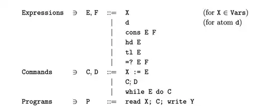

Similar to @user21820's way, I recommend a classic textbook Computability and Complexity: From a Programming Perspective by Neil Deaton Jones. It introduce computability rigorously but in a very plain, alternative and elegant way.
In the beginning of this book, the author introduced a very simple WHILE language first and also gave the syntax and semantic of that language rigorously. For example the syntax is as below.
The WHILE language here is based on command and then is imperative, but its data is a binary tree structure. And we know that program itself is also data, so this settings are very convenient to unify program and data.
In the following chapter, basic background of programming language theory is given, such as interpreter, compiler, specifier and related concepts ...
Based on WHILE language, the author leads us to the beautiful garden of computability and complexity in a very special path.

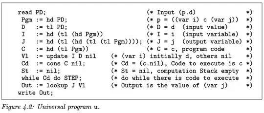

For example, the universality of computing is introduced by a self-interpreter which is a program.

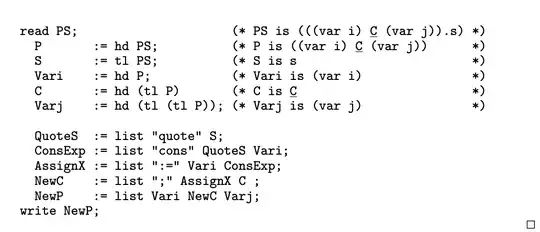

And also the core part of the proof for s-m-n theorem is also a program.
At least for me, this fascinating book is very elegant.
So you probably can use a program to describe your algorithm and then proof it through the formal semantic of the WHILE language.
