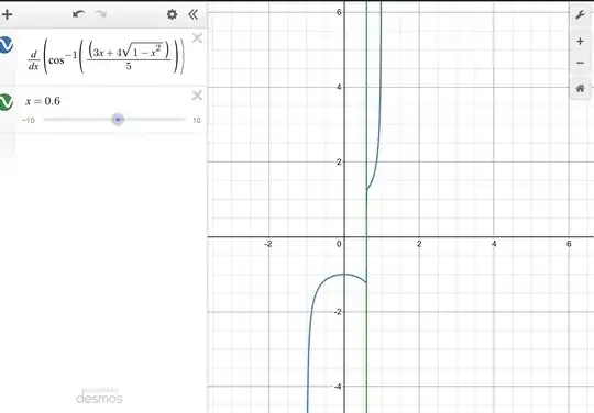

All in all, $$\dfrac{\mathrm dy}{\mathrm dx}= \begin{cases}\dfrac{-1}{\sqrt{1-x^2}} &&\text{if }\;-1<x<0.6; \\\dfrac{1}{\sqrt{1-x^2}} &&\text{if }\;0.6<x<1; \\\text{undefined} &&\text{otherwise}. \end{cases}$$
According to Wolfram Alpha and Desmos, an equivalent rewrite avoiding cases is $$\dfrac{\mathrm dy}{\mathrm dx}=\frac{4x- 3\sqrt{1 - x^2}}{\sqrt{(1 - x^2)(7 x^2 - 24 \sqrt{1 - x^2} x + 9)}};$$ that is, $$\dfrac{\mathrm dy}{\mathrm dx}=\frac{4x- 3\sqrt{1 - x^2}}{\left| 4x- 3\sqrt{1 - x^2} \right|\sqrt{1 - x^2}}.$$

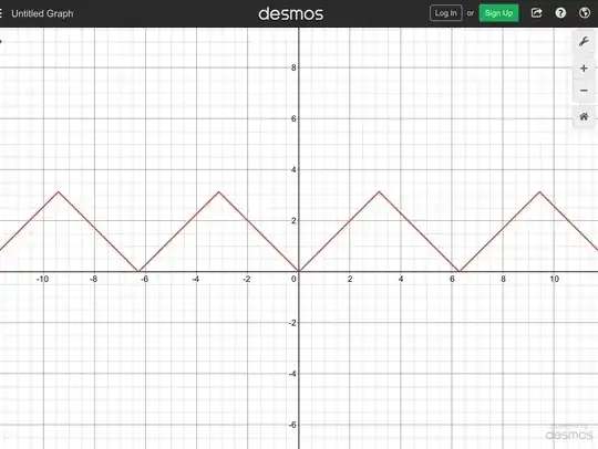

$\cos^{-1}(\cos x)$ needn’t always be equal to $x$. See the graph below for $\cos^{-1}(\cos x)$ :
When $x < 0$ then $\cos^{-1}(\cos x) = -x$.
Now if $x < 0.6$ then $\beta >\alpha$ because $\cos^{-1} x$ is a decreasing function in $[-1, 1]$. So ideally there should be two cases, $x < 0.6$ and $x > 0.6$.
Also note that in your substitution, you are perfectly entitled to restrict the values of $\alpha$ to $(0,\frac{\pi}{2})$ so there is nothing wrong in taking $\sin x =0.8$.
As you will notice, there is a discontinuity in the graph at $x= 0.6$: enter image description here
