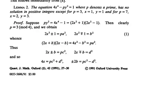

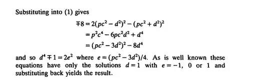

Clarification: the question was directly taken from the following:
