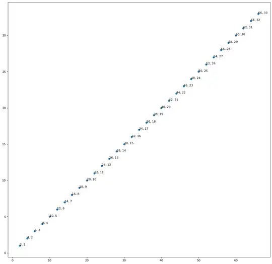

Class (2,1) Graph
Linear Relationship for Class (2, 1), Dropping Time = 1

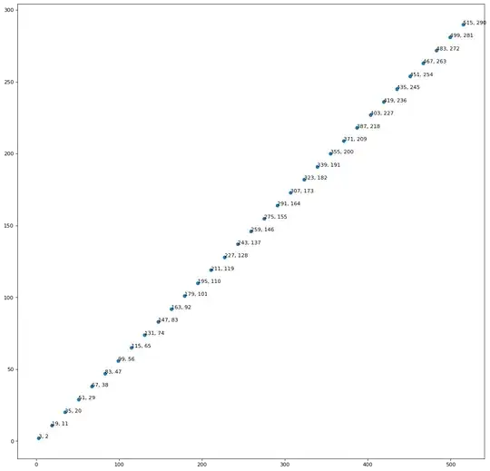

Class (16, 9) Graph
Linear Relationship for Class (4, 3), Dropping Time = 6

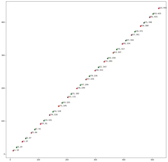

Collatz Class (32, 27)
To start off, let's look at the graph of this class, just like we did with the trivial classes.

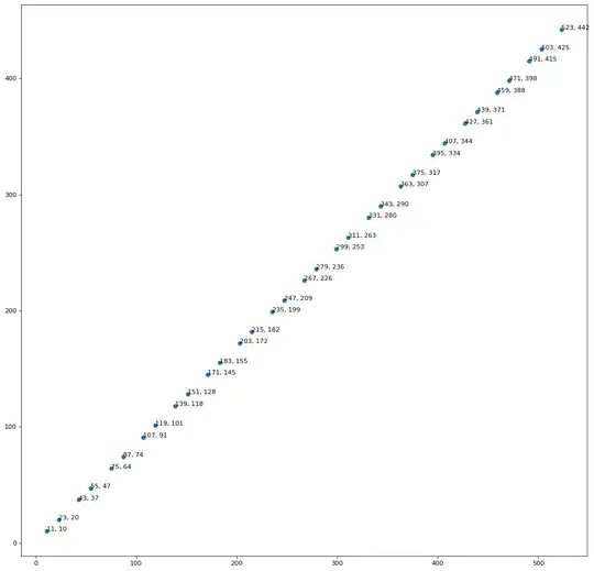

Linear Relationship for Class (32, 27), Dropping Time = 8
It's hard to spot by eye, but you can definitely see that though these numbers are linear in their relationship, they are not distributed evenly as a whole. They seemed to be grouped into sets of two, I call these sub-classes. This is why I classify these classes of having a mod-interval of 2 - there are 2 subclasses. Each element in this class satisfies at least one of the following conditions:
  • n % 32 = 11
  • n % 32 = 23
Now, if we redraw the graph and color and distinguish the elements by color, indicating which rule they obey within this class, you'll be able to see the relationship.
  • Elements where n % 32 = 11 are RED
  • Elements where n % 32 = 23 are GREEN
It's much easier to see how, within each subclasses, each element is nicely spaced out. Not only are the elements linear, but they're distributed evenly, just like the trivial classes! So in a way, the subclasses resemble the nontrivial classes.

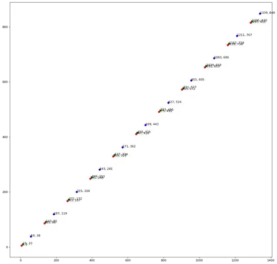

Just for fun, I'll include one last bit of data for the (128, 81) Class.
Collatz Class (128, 81), mod-interval: 3
Subclasses:
  • n % 128 = 7 (RED)
  • n % 128 = 15 (GREEN)
  • n % 128 = 59 (PURPLE)
Linear Relationship for Class (128, 81), Dropping Time = 11

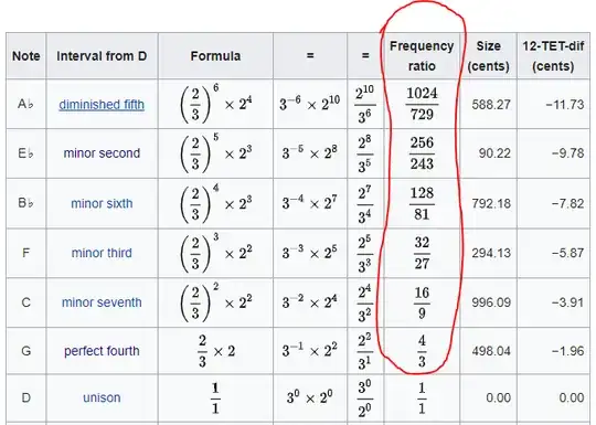

  • There may be a connection to music theory here. It may be somewhat of a stretch, but if you interpret the Collatz Classes as musical intervals, there is a very close relationship to Pythagorean Tuning. Below is a table from the wiki:
Pythagorean Tuning Intervals - From D
The frequencies circled in red correspond directly to the first set of Collatz Classes we observe (excluding class (2,1), which would be an "octave" in music theory). Perhaps there are methods from harmonic analysis that can be used investigate Collatz. Again, it may be a coincidence, but perhaps we could explore this relationship and see if there any new tools we can use on Collatz.
