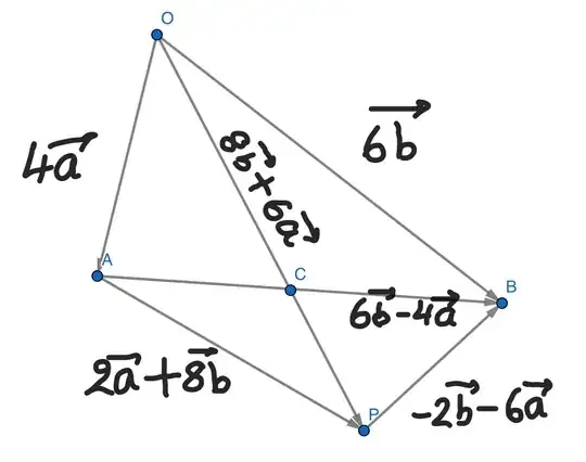

$\textbf{Question:}$ $OAB$ is a triangle.
$Q$ is the point on $AB$ such that $OQP$ is a straight line, where $P$ is a point outside of the triangle.
$$\overrightarrow{OA}=4\bf{a},$$ $$\overrightarrow{OB}=6\bf{b},$$ $$\overrightarrow{AP}=2\bf{a}+\bf{8}b$$
Using a vector method, find the ratio, $AQ:QB$
$\textbf{Attempted solution:}$ I thought I had solved it, but then I realised I had made various assumptions, including the incorrect fact that $Q$ is the midpoint of $OP$. However, I think this much is correct: $$\overrightarrow{AQ}=-\bf{a}+4\bf{b}$$ $$\overrightarrow{QB}=-3\bf{a}-2\bf{b}$$ But I can't write these as factors of one another, so I've either made a mistake or there's something I'm not seeing. I also realised that I can't use Pythagoras' theorem because the vectors aren't necessarily orthogonal.
