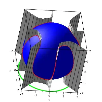

Good Intersection between Hyperbolic plane and a Sphere.
[> with(plots): [> with(plots, intersectplot): a1 := plot3d((x^8-y^8)*x*y, x = -2 .. 2, y = -2 .. 2, numpoints = 10000, color = grey); a2 := implicitplot3d(x^2+y^2+z^2 = 4, x = -2 .. 2, y = -2 .. 2, z = -2 .. 2, axes = box, style = patchnogrid, numpoints = 80000); a3 := intersectplot((x^8-y^8)*x*y = z, x^2+y^2+z^2 = 4, x = -2 .. 2, y = -2 .. 2, z = -2 .. 2, axes = box, thickness = 4, orientation = [0, 0]); a4 := spacecurve([2*sin(t), 2*cos(t), -2], t = -6 .. 6, color = green, thickness = 3); display(a1, a2, a3, a4);

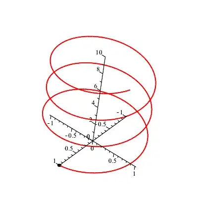

Moving a particle along a vector function:
[> with(plots); f1 := proc (rho, phi, theta) options operator, arrow; rho*cos(theta)*sin(phi) end proc; f2 := proc (rho, phi, theta) options operator, arrow; rho*sin(theta)*sin(phi) end proc; f3 := proc (rho, phi, theta) options operator, arrow; rho*cos(phi) end proc; s := spacecurve([cos(2*t), sin(2*t), t], t = 0 .. 10, axes = normal, color = red, thickness = 2, numpoints = 200); w := animate3d([cos(2*t)+f1(0.3e-1, phi, theta), sin(2*t)+f2(0.3e-1, phi, theta), t+f3(0.3e-1, phi, theta)], phi = -4 .. 4, theta = -4 .. 4, t = 0 .. 10, frames = 50); display(s, w);

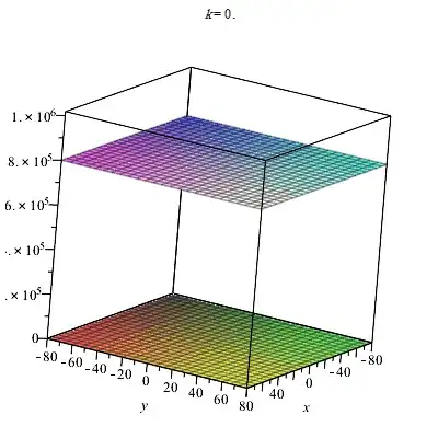

Or this ones:
[> with(plots): W := animate(plot3d, [k*(x^2+y^2)^.5, x = -80 .. 80, y = -80 .. 80], k = 0 .. 9000, frames = 40); G := animate(plot3d, [800000-k*(x^2+y^2), x = -80 .. 80, y = -80 .. 80], k = 0 .. 50, frames = 40); Y := plot3d(0, x = -80 .. 80, y = -80 .. 80, axes = normal); display({G, W, Y});

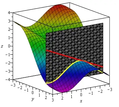

Another example with Maple. (Maple 2016)
restart; with(plottools):
with(plots); with(Student[Calculus1]):
f := proc (x, y) options operator, arrow;sin(x+y)-y end proc;
a := -1; b := 2; xmin := -3;
ymin := -3; zmin := -3; xmax := 3; ymax := 3; zmax := 3;
p1 := implicitplot3d(y = b, x = xmin .. xmax, y = ymin .. ymax, z = zmin .. zmax, color = gray, style = surfacewireframe);
p2 := plot3d(f(x, y), x = xmin .. xmax, y = ymin .. ymax, shading = zhue);
g := f(x, b); teget := Tangent(g, x = a);
to3d := transform(proc (x, y) options operator, arrow; [x, b, f(x, b)] end proc);
p3 := plot(g, x = xmin .. xmax, z = zmin .. zmax, thickness = 5, color = yellow);
p4 := plot(teget, x = xmin .. xmax, z = -zmin .. zmax, thickness = 3, color = red);
to3d2 := transform(proc (x, y) options operator, arrow; [x, b, y] end proc);
p5 := implicitplot3d(z = teget, x = xmin .. xmax, y = ymin .. ymax, z = zmin .. zmax, color = green, style = surface);
display(p1, p2, to3d(p3), to3d2(p4), axes = boxed);
