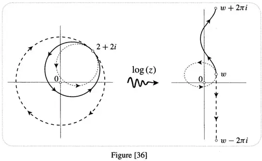

In this page, it is shown how as we circular about the circle $\omega$ moves to different points. I am struggling to understand how the curve bends when moving. Could someone explain that?

I won't try and give some calculation with number but rather a qualitative answer for you. I'll show how to "see" the situation qualitatively for the counter-clockwise motion.

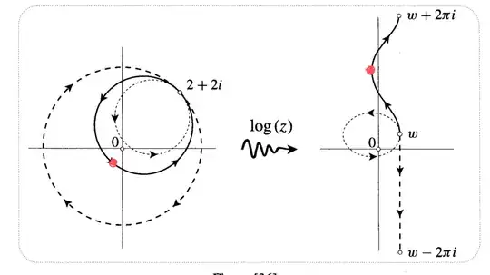

Firstly notice that if you were to move around the circle counter-clockwise, initially the magnitude of $|z|$ is decreasing as the point on circle is closer and closer to origin and later after the redpoint I marked here, it will increase again:
What about the angle? Well if you were initially at $\theta$, as you spin around the circle, you gain more and more angle till you return to the initial point where you have total $2\pi$ more angle. That why the curve is going up.
