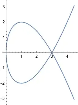

Update: The group can be constructed as an Elliptic Curve Group on $\mathbb F_p$ for the curve $y^2=x(x-a)^2$, where $(x,y)=(u^2,u(u^2-a))$. That curve, with the field $\mathbb R$. y^2=x(x-a)^2
