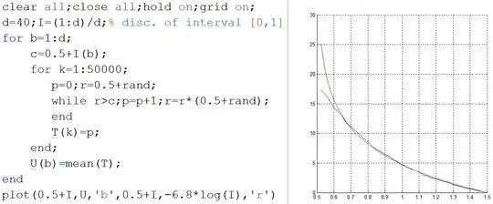

Instead, I have written a program in order to conduct extensive simulations of the average number $u=u(c)$ of "time units" necessary to fall below a certain given value $c \in [1/2,3/2]$ (see Matlab program below)
The obtained results (blue curve) display a rather good fit by a certain $-K * ln$ function (red curve ; with $K=6.85$) but for the initial values of $c$. The fit is especially good in the central region which is of interest for you ; for example, for $c=1$, one obtains $u(c) \approx 4.75$, a rather counter intuitive result...

  • Thanks a lot for the simulation! – Marco_L_T May 20 '22 at 01:53
