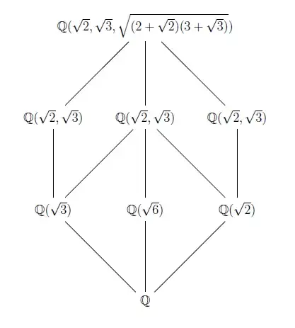

Consider the Galois extension $K:=\mathbb{Q}(\sqrt 2, \sqrt 3, \sqrt{(2+\sqrt 2)(3+\sqrt 3)})/\mathbb{Q}$. As it is clear, it is of degree $8$ extension. So the Galois group is a group of order $8$. I want to identify the Galois group and want to draw its lattice diagram.
For the first glance, it seems the following is the lattice diagram.
But I think I am missing some $i=\sqrt{-1}$ in the whole picture. We note the Galois group of the subextension $\mathbb{Q}(\sqrt 2, \sqrt 3)/\mathbb{Q}$ is isomorphic to $\mathbb{Z}_2 \times \mathbb{Z}_2$ with the following lattice diagram:
I think the Galois group of $K/\mathbb{Q}$ is not abelian. For, the conjugates of $\alpha=\sqrt{(2+\sqrt 2)(3+\sqrt 3)}$ are $\pm \sqrt{(2\pm\sqrt 2)(3\pm\sqrt 3)}$. We have the following $8$ automorphisms: $$\sqrt{(2+\sqrt 2)(3+\sqrt 3)} \to \pm \sqrt{(2\pm\sqrt 2)(3\pm\sqrt 3)}$$ Denote $\beta=\sqrt{(2+\sqrt 2)(3-\sqrt 3)}$ , $\gamma=\sqrt{(2-\sqrt 2)(3+\sqrt 3)}$. Let $\tau, \eta$ be two automorphisms in the Galois group with \begin{align*} &\tau(\alpha)=\beta,~~ \sqrt 2 \mapsto \sqrt 2,~~ \sqrt 3 \mapsto -\sqrt 3 \\ &\eta(\alpha)=\gamma, ~~ \sqrt 2 \mapsto \sqrt -2,~~ \sqrt 3 \mapsto \sqrt 3 \end{align*} Then $\tau \circ \eta \neq \eta \circ \tau$.
So either the Galois group is $D_4$ or $Q_8$. According to the first diagram shows one subgroup of order $4$ corresponding to $\mathbb{Q}(\sqrt 2, \sqrt 3)$ while $D_4$ has $3$ subgroups of order $4$. So the Galois group is $Q_8$, I think.

    I'm not sure how you could be missing any $i$s in the picture — all of the conjugates $\pm\sqrt{(2\pm\sqrt{2})(3\pm\sqrt{3})}$ certainly look real to me? – Steven Stadnicki May 12 '22 at 14:46
  • $Q_8$ has only a single subgroup of order two, but $D_4$ has three. Correspondingly there will be either a single intermediate field of degree $8/2=4$ or three of them. – Jyrki Lahtonen May 12 '22 at 14:49
  • @JyrkiLahtonen, so it is $Q_8$. – MAS May 12 '22 at 15:34

    An alternative argument may be to observe that in $D_4$ the two elements of order four are each others inverses. I take it that you proved both $\tau$ and $\eta$ to have order four? – Jyrki Lahtonen May 20 '22 at 11:41
