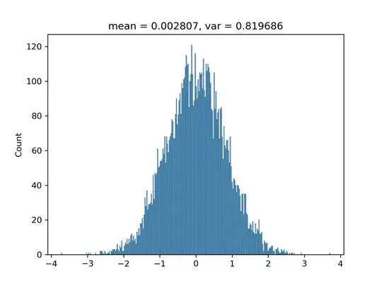

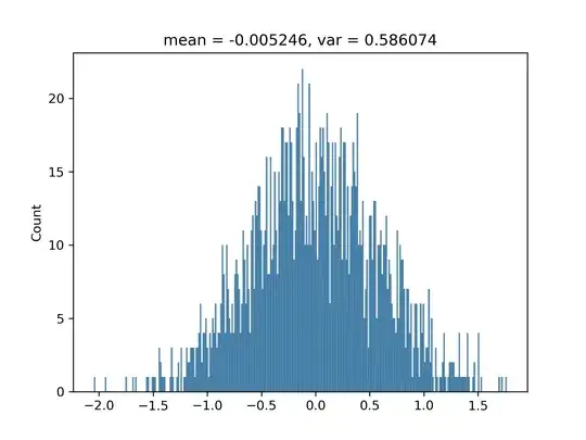

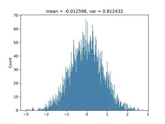

Here is my Python code for experiments:
import numpy as np
for i in range(3): n = np.random.randint(2, 10000) m = np.random.randint(1, n)
A = np.random.randn(m, n) * ((1 / m) ** 0.5)
x = np.random.rand(n,)
e = np.matmul(np.eye(n) - np.matmul(np.transpose(A, [1, 0]), A), x)  # (I-A'A)x
print(np.linalg.norm(x) * ((1/m) ** 0.5))
print(np.std(e))
print('===')
try:
    from matplotlib import pyplot as plt
    import seaborn
    plt.cla()
    seaborn.histplot(e, bins=300)
    plt.title('mean = %f, var = %f' % (float(e.mean()), float(e.std())))
    plt.savefig('%d.png' % i, dpi=300)
except:
    pass
The standard deviation and the predicted one are generally matched (I have run the code multiple times):
0.7619008975832263
0.7371794446157226
0.5792213637974852
0.5936062808535417
0.5991335956466841
0.6256026437096703

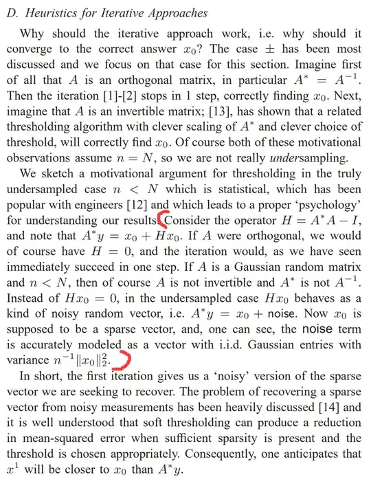

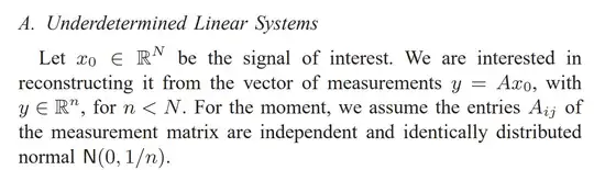

Here are two fragments of the paper:
(from Sec. I-A)
(from Sec. I-D)

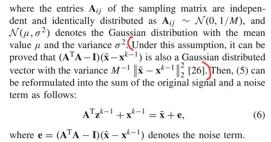

Additionally, this paper [Paper Link] published on IEEE Transactions on Image Processing 2021 refers this conclusion (around the Equation (6)):

    Hi @WilliamM., the reference $[26]$ is actually the first paper "Message Passing Algorithms for Compressed Sensing" I mentioned, which propose the conclusion confusing me (see 1. Background), and is one of the foundation works in compressed sensing (CS) fields. – BinChen May 13 '22 at 02:13
  • In 5. Appendix, the former two pictures correspond to the first paper (published in 2009), and the latter one corresponds to the second paper (a more recent one published in 2021). – BinChen May 13 '22 at 02:16

    @WilliamM. is correct; they are relying on the CLT. On page 11 they wrote: "In the main text, our motivation of the SE formalism used the assumption that the mutual access interference term $MAI_t = (A^∗A−I)(x_t − x_0)$ is marginally nearly Gaussian." – Syd Amerikaner May 20 '22 at 10:59
    Nevertheless, if you want to work out the finite sample distribution of $I - A^A$, you can use that $W = A^A$ follows a Wishart distribution. The difficulty is now to obtain the distribution of the shift $I - W$ from the pdf of the Wishart distribution. Next, you would have to find the distribution of $(I-W)x_0$. This could be seen as some kind of scaling, but since $x_0$ could contain negative values, I think it will be very hard to work out the exact distribution – Syd Amerikaner May 20 '22 at 11:21
  • Hi @SydAmerikaner, I notice the sentence in the Appendix. K you mentioned. Now I am not attached to this and accept your ideas. The approximation actually plays a non-negligible role in the context. I am grateful for your efforts and kind reminder. – BinChen May 20 '22 at 12:38
