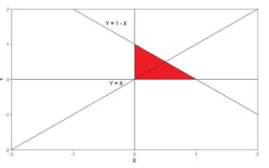

The region of integration of $\rho$ is given by the red below.

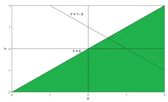

Consider, in addition, the line $Y = X$. The region for which $Y \leq X$ is given by the green.

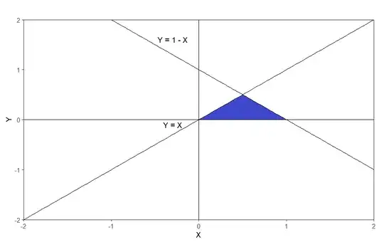

The intersection of the red and green regions will give you the appropriate region of integration to calculate $P(Y \leq X)$, given in blue:

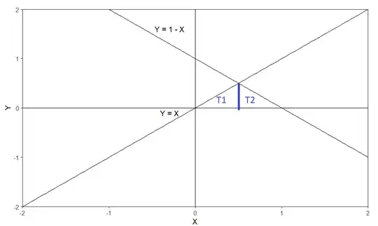

My suggestion would be to partition this triangle into two regions $T_1$ and $T_2$:

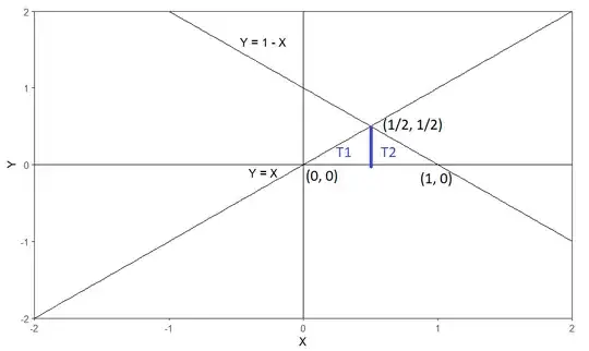

The intersection of the two lines occurs when $X = 1 - X$, or $2X = 1$, or $X = 1/2$, where $Y = 1/2$ as well. I have also included other points worth noting.
The region $T_1$ is given by $X$-bounds of $0$ and $1/2$, and $Y$-bounds of $0$ and $X$.
The region $T_2$ is given by $X$-bounds of $1/2$ and $1$, and $Y$-bounds of $0$ and $1 - X$.
Therefore, the desired probability is given by $$\int_{0}^{1/2}\int_{0}^{x}\rho(x, y)\text{ d}y\text{ d}x + \int_{1/2}^{1}\int_{0}^{1-x}\rho(x, y)\text{ d}y\text{ d}x = \dfrac{1}{2}\text{.}$$
