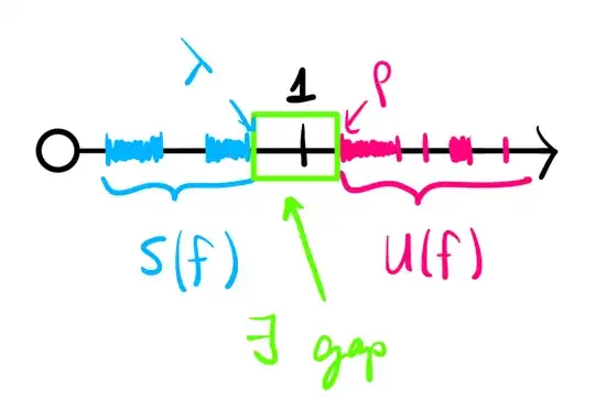

In ODE theory this situation is sometimes referred to as an exponential $(\lambda,\rho)$-dichotomy. The actual numbers become important when it comes to subtle estimates (or more sophisticated versions of hyperbolicity), but roughly the idea is that that there are such constants guarantees a good separation of vectors that correspond to infinitesimally different behaviors; any vector approximates arbitrarily well either a vector in the stable subbundle or the unstable subbundle if enough time passes. This provides a robust theory (e.g. in the definition above one doesn't need to assume that the splitting is continuous; in fact not only is it continuous but Hölder continuous). I personally find the "Mather diagram" very useful to keep track of such numbers, such a diagram looks like this:
(What this is is really the spectrum, up to rotation, of the adjoint operator of $f$ acting on the space of continuous vector fields; $X\mapsto Tf\circ X\circ f^{-1}$.)
