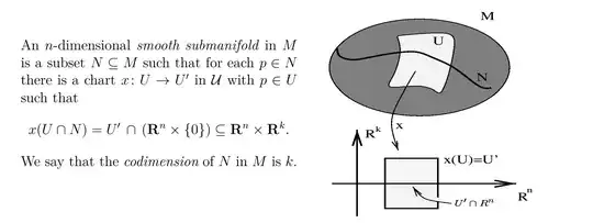

I am having a hard time in proving that it is a submanifold, what exactly should we do to prove that it is a submanifold? I think I do not understand the definition very well.
Here is the definition of a submanifold I am using:

To prove that $f(\mathbb{R}P^n)\subset \mathbb{R}P^{n+1}$ is a submanifold, we just use the first $n+1$ charts of $\mathcal{A}^{n+1}$. Indeed, for any $(p_0,\dots, p_n)\in\mathbb{R}^{n+1}\setminus\{0\}$, there is an $i< n+1$ for which $p_i\neq 0$. Then $U_i^{n+1}$ is an open neighborhood of $f([p_0, \dots, p_n])$. Moreover, the last coordinate of $\phi_i^{n+1}([r_0,\dots,r_{n+1}])$ vanishes if and only if $r_{n+1} = 0$. Thus, $U_i^{n+1}\cap f(\mathbb{R}P^n) = \{[p_0,\dots,p_n,0], p_i\neq 0\} = \{r\in U_i^{n+1}, x_i^{n+1}(r)=0\}$, and $f(\mathbb{R}P^n)$ is an $n$-dimensional submanifold of $\mathbb{R}P^{n+1}$.
These charts are what are called adapted charts for the submanifold $f(\mathbb{R}P^n)$, and we will use them to prove the smoothness of both $f$ and $f^{-1}$.
