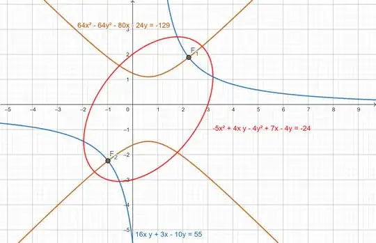

Follow [Breiding, Kohn, Sturmfels 2023] in defining a focus of a plane algebraic curve $C$ as a point $F$ which together with the circular points at infinity span lines that are tangent to $C$.
From [Salmon 1879], when the equation $S=ax^2+2bxy+cy^2+2dx+2ey+f=0$ defines a conic, the two conics $$S_{1}^2-S_{2}^2-2 S (S_{11}-S_{22})=0$$ and $$S_{1} S_{2}-2 S S_{12}=0,$$ where $S_1=\frac{\partial S}{\partial x}, S_2=\frac{\partial S}{\partial y}$ etc. intersect in the (four, two real) foci.
For example the ellipse $-5x^2 + 4x y - 4y^2 + 7x - 4y + 24=0$ has foci given by the intersection of $64x^2 - 64y^2 - 80x - 24y + 129=0$ with $16x y + 3x - 10y - 55=0.$
The real foci of a conic as the intersection of two associated conics
