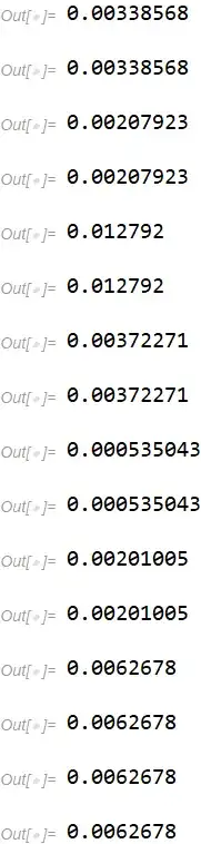

This finishes the proof. As always we provide Mathematica code that verifies all the partial results:
(*Integrating over l2 \in (l1,1)*)
{x} = RandomReal[{1, 10}, 1];
l1 = RandomReal[{1/2, 1}];
NIntegrate[
 Abs[(2 l1 - l2) (l1 + l2 - 1)] Abs[-2 l2 + l1 +
    1] l1^(x - 1) (l2 - l1)^(x - 1) (1 - l2)^(x - 1), {l2, l1, 1}]
(2^(-1 - 2 x) (1 - l1)^(2 x) l1^(-1 + x))/(1 + x) - (
 3 4^-x (1 - l1)^(2 x) l1^x)/(1 + x) + (
 9 2^(-1 - 2 x) (1 - l1)^(2 x) l1^(1 + x))/(1 + x) - (
 2^(1 - 2 x) (1 - l1)^(2 x) l1^x)/(x + x^2) + (
 4^(1 - x) (1 - l1)^(2 x) l1^(1 + x))/(x + x^2)
l1 = RandomReal[{1/3, 1/2}]; NIntegrate[ Abs[(2 l1 - l2) (l1 + l2 - 1)] Abs[-2 l2 + l1 + 1] l1^(x - 1) (l2 - l1)^(x - 1) (1 - l2)^(x - 1), {l2, l1, 1}] (2^(-1 - 2 x) (1 - l1)^(2 x) l1^(-1 + x))/(1 + x) - ( 3 4^-x (1 - l1)^(2 x) l1^x)/(1 + x) + ( 9 2^(-1 - 2 x) (1 - l1)^(2 x) l1^(1 + x))/(1 + x) - ( 2^(1 - 2 x) (1 - l1)^(2 x) l1^x)/(x + x^2) + ( 4^(1 - x) (1 - l1)^(2 x) l1^(1 + x))/(x + x^2) - ( 8 (1 - 2 l1)^x l1^(1 + 2 x))/(x + x^2) + (4 ((1 - 2 l1) l1^2)^x)/( x + x^2)
l1 = RandomReal[{0, 1/3}]; NIntegrate[ Abs[(2 l1 - l2) (l1 + l2 - 1)] Abs[-2 l2 + l1 + 1] l1^(x - 1) (l2 - l1)^(x - 1) (1 - l2)^(x - 1), {l2, l1, 1}] (2^(-1 - 2 x) (1 - l1)^(2 x) l1^(-1 + x))/(1 + x) - ( 3 4^-x (1 - l1)^(2 x) l1^x)/(1 + x) + ( 9 2^(-1 - 2 x) (1 - l1)^(2 x) l1^(1 + x))/(1 + x) - ( 2^(1 - 2 x) (1 - l1)^(2 x) l1^x)/(x + x^2) + ( 2 (1 - 2 l1)^x l1^(2 x))/(x + x^2) + ( 4^(1 - x) (1 - l1)^(2 x) l1^(1 + x))/(x + x^2) - ( 4 (1 - 2 l1)^x l1^(1 + 2 x))/(x + x^2) + (2 ((1 - 2 l1) l1^2)^x)/( x + x^2) - (4 l1 ((1 - 2 l1) l1^2)^x)/(x + x^2)
(Integrating over l1 \in (0,1) ) NIntegrate[ Abs[(2 l1 - l2) (l1 + l2 - 1)] Abs[-2 l2 + l1 + 1] l1^(x - 1) (l2 - l1)^(x - 1) (1 - l2)^(x - 1), {l1, 0, 1/3}, {l2, l1, 1}] (2^(-1 - 2 x) Beta[1/3, x, 1 + 2 x])/(1 + x) - ( 3 4^-x Beta[1/3, 1 + x, 1 + 2 x])/(1 + x) - ( 2^(1 - 2 x) Beta[1/3, 1 + x, 1 + 2 x])/(x + x^2) + ( 9 2^(-1 - 2 x) Beta[1/3, 2 + x, 1 + 2 x])/(1 + x) + ( 4^(1 - x) Beta[1/3, 2 + x, 1 + 2 x])/(x + x^2) + ( 2^(1 - 2 x) Beta[2/3, 1 + 2 x, 1 + x])/(x + x^2) - ( 2^(1 - 2 x) Beta[2/3, 2 + 2 x, 1 + x])/(x + x^2)
NIntegrate[ Abs[(2 l1 - l2) (l1 + l2 - 1)] Abs[-2 l2 + l1 + 1] l1^(x - 1) (l2 - l1)^(x - 1) (1 - l2)^(x - 1), {l1, 1/3, 1/2}, {l2, l1, 1}] 1/(x (1 + x)) 2^(-1 - 2 x) (-x Beta[1/3, x, 1 + 2 x] + (4 + 6 x) Beta[1/3, 1 + x, 1 + 2 x] - 8 Beta[1/3, 2 + x, 1 + 2 x] - 9 x Beta[1/3, 2 + x, 1 + 2 x] + x Beta[1/2, x, 1 + 2 x] - 4 Beta[1/2, 1 + x, 1 + 2 x] - 6 x Beta[1/2, 1 + x, 1 + 2 x] + 8 Beta[1/2, 2 + x, 1 + 2 x] + 9 x Beta[1/2, 2 + x, 1 + 2 x] - 4 Beta[2/3, 1 + 2 x, 1 + x] + 4 Beta[2/3, 2 + 2 x, 1 + x] + 4 Beta[1, 1 + 2 x, 1 + x] - 4 Beta[1, 2 + 2 x, 1 + x])
NIntegrate[ Abs[(2 l1 - l2) (l1 + l2 - 1)] Abs[-2 l2 + l1 + 1] l1^(x - 1) (l2 - l1)^(x - 1) (1 - l2)^(x - 1), {l1, 1/2, 1}, {l2, l1, 1}] 1/(x (1 + x)) 2^(-1 - 2 x) (-x Beta[1/2, x, 1 + 2 x] + (4 + 6 x) Beta[1/2, 1 + x, 1 + 2 x] - 8 Beta[1/2, 2 + x, 1 + 2 x] - 9 x Beta[1/2, 2 + x, 1 + 2 x] + x Beta[1, x, 1 + 2 x] - 4 Beta[1, 1 + x, 1 + 2 x] - 6 x Beta[1, 1 + x, 1 + 2 x] + 8 Beta[1, 2 + x, 1 + 2 x] + 9 x Beta[1, 2 + x, 1 + 2 x])
(The whole thing.) NIntegrate[ Abs[(2 l1 - l2) (l1 + l2 - 1)] Abs[-2 l2 + l1 + 1] l1^(x - 1) (l2 - l1)^(x - 1) (1 - l2)^(x - 1), {l1, 0, 1}, {l2, l1, 1}] 1/(x (1 + x)) 2^(-1 - 2 x) (x Beta[1, x, 1 + 2 x] - 2 (2 + 3 x) Beta[1, 1 + x, 1 + 2 x] + 8 Beta[1, 2 + x, 1 + 2 x] + 9 x Beta[1, 2 + x, 1 + 2 x] + 4 Beta[1, 1 + 2 x, 1 + x] - 4 Beta[1, 2 + 2 x, 1 + x]) (9 2^(1 - 2 x) Gamma[2 x] Gamma[2 + x])/Gamma[4 + 3 x] (3 Gamma[1/2 (-2 + T)] Gamma[1/2 (-1 + T)] Gamma[T/2])/( Sqrt[[Pi]] Gamma[(3 T)/2]) /. T :> 2 x + 2
