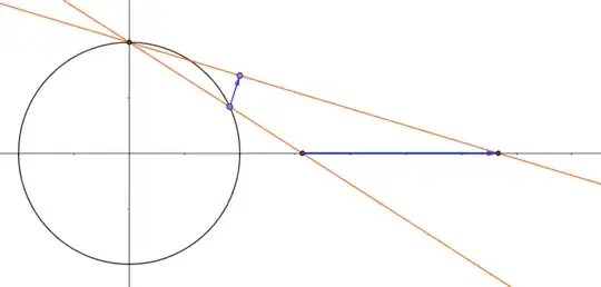

What I don't understand well is because the stereographic projection guarantees me tangentiality, for example in the following image I can think of a vector field not tangent to a meridian, from which I extract a vector, and project it onto the plane, this projection would give us vectors with the same properties as the $\pi(X)$ projection.

  • @Zaragosa I believe Prof. Shifrin's neat argument makes it clear enough (although of course it works because of the symmetry of the given vector field). The issue with your s.p. argument seems to be that you are applying $\pi$ to the vector as well, but the derivative of $\pi$ ought to be applied. Put differently, the $X$ you drew in your addendum is not a tangent vector; given any vector on the plane there will be a unique vector tangent to the sphere compatible with s.p. – Alp Uzman Apr 16 '22 at 23:45
