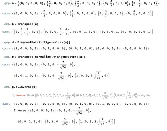

How do I raise a matrix to the infinite power? I know that the main method for doing this is by diagonalizing the matrix, but what if I can't?
For example, let's say I have the matrix
\begin{bmatrix}0&0&0&0&0\\2/3&0&0&0&0\\1/3&0&1&0&0\\0&3/7&0&1&0\\0&4/7&0&0&1\end{bmatrix}
You can see that when I try diaganolizing the matrix in Mathematica, the eigenvector matrix is singular, so I'm unable to take its inverse.
However, I know that when I raise this matrix to the power of infinity, I know I get the following matrix
\begin{bmatrix}0&0&0&0&0\\0&0&0&0&0\\1/3&0&1&0&0\\2/7&3/7&0&1&0\\8/21&4/7&0&0&1\end{bmatrix}
Is there any general algorithm or formula or steps I can take to get there?

    Are you familiar with Jordan normal form? Try using that instead. Not all matrices are diagonalizable, but Jordan normal form always exists. – Jair Taylor Apr 12 '22 at 17:25

  • @Jair Taylor How would I use Jordan normal form because the point of using diagonalization was to get a matrix that was zero except all along the diagonal which would be very easy to raise to the power of infinity. Is there a way for me to get the matrix of the Jordan normal form raised to the power of infinity? – Undefined Apr 12 '22 at 20:28
    @Somos How about $ M=\left[\begin{array}{l}1&0\0&\frac{1}{2}\end{array}\right]? $ Then $M^n$ converges and never repeats. – Jair Taylor Apr 12 '22 at 20:37
    @Undefined You can handle each Jordan block separately - you'll have to think through what happens. I believe blocks with eigenvalues $|\lambda| < 1$ will tend to 0. – Jair Taylor Apr 12 '22 at 20:40

An ad-hoc observation
Your matrix is of the form $D+N$ where $D$ is a diagonal matrix with entries $[0,0,1,1,1]$, and $$ N = \begin{pmatrix} 0&0&0&0&0\\ \frac 23 &0&0&0&0\\ \frac 13&0&0&0&0\\ 0&\frac 37&0&0&0\\ 0&\frac 47&0&0&0 \end{pmatrix} $$
In particular, observe that $ND = 0$ (note : $DN \neq 0$) and $N^3=0$ (Note : $N^2\neq 0$). One can explicitly compute the non-zero matrices $DN$ and $N^2$ for reference.
Therefore , imagine that we are computing $(D+N)^k$. For simplicity, take $k=2$. We get the terms $D^2+DN+ND+N^2$ which simplifies to $D^2+DN+N^2$.
Now let's take $k=3$. We get $$ D^3+D^2N+DND+DN^2+ND^2+NDN+N^2D+N^3 $$ Every term containing either an $ND$ or $N^3$ will vanish. This leaves exactly $$ D^3+D^2N+DN^2 $$
Are you seeing a pattern?
Generalizing the pattern $+$ completing the problem
Indeed, which terms of the summation will survive from $(D+N)^k$? For starters, you can't have a $D$ following an $N$ because $ND = 0$. Therefore, the only terms that will survive must have a run of $D$s followed by a run of $N$s i.e. it must be of the form $D^{l}N^{k-l}$.
However, because $N^3 = 0$ we know that $k-l \leq 2$! That leaves us with $$ D^{k-2}N^2+D^{k-1}N + D^k $$
However, here's the interesting part : $D$ is diagonal with entries $[0,0,1,1,1]$, and therefore $D^k$ (for any $k$) is diagonal with entries $[0^k,0^k,1^k,1^k,1^k]$ : which is just equal to $D$!
Finally, we get for ANY $k$ that $$ (D+N)^k = D(N^2+N+I) $$
and therefore, rather obviously, $$ \lim_{k \to \infty} (D+N)^k = D(N^2+N+I) $$
as desired. Compute this quantity for your $D$ and $N$ to see what you get.
