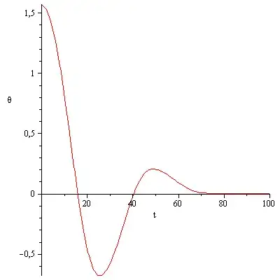

Is the solution to $\ddot{\theta}+0.021\,\text{sgn}(\dot{\theta})\sqrt{|\dot{\theta}|}+0.02\sin(\theta)=0,\,\,\theta(0)=\frac{\pi}{2},\,\dot{\theta}(0) = 0 \quad\text{(Eq. 1)}$ of finite duration?
I would like to know if the solution is of finite duration, meaning this that the solution reaches zero in finite time and stays there forever after (instead of being "vanishing at infinity"): this means I need to prove if there exists a finite extinction time such after it passes the solution becomes zero and stays there $$\exists\,\, T<\infty \,/ \,\theta(t)=0 \,\,\forall t\geq T $$
Looking for a mathematical prove of that (theoretical or numerical, but such as confirms without any doubt if is truly a solution of finite duration).
Numerical solution to Eq . 1

  1. Solving Eq. 1 for $\ddot{\theta}(t) = 0$ leads to a $\tan^{-1}$ which never achieves exactly zero. Here is the attempt done by other person in the question of the physics forum. Interestingly are found a time $T \approx 90$ which is similar to the plot ending.

    This differential equation does not have a closed-form solution in terms of elementary functions. If you want to prove convergence to zero in finite-time, you will have to build a Lyapunov function for that. – KBS Mar 24 '22 at 07:55
    Technically, your first example $\overset{.}{y}=-\sqrt y,y(0)=1$ has finite duration because when it hits zero, the derivative remains zero; with the square root defined nonnegative but having a minus sign before it the solution can never rise again. – Oscar Lanzi Mar 26 '22 at 14:01
  • @OscarLanzi That is interesting, I didn't think of it before... I take the example as a slight modification of this video example.. if you know other examples please take a look into this question. – Joako Mar 26 '22 at 21:10
  • @KBS I tried to to follow your advice and start reading the the book of Khalil, and slowly I am getting the main ideas, but is too advanced for me to trying to use its tools by now: even understanding a bit now, I got lost on the paper of Bhat & Bernstein, since is also required to know metrics, norms, and other advanced math things (at least advanced for the electrician syllabus from where I come). So I want your opinion: Is this question really a TOO HARD thing to prove? (so it is unlikely to get an answer don't matter how much reputation points I would offer on the bounties? – Joako Mar 29 '22 at 23:37
    @Joako Yes, your question is difficult as there there is no explicit solution to your equation and it needs to be tackled independently, which may take a lot of time. A local Lyapunov function could be built but this is far from being straightforward. This problem is basically publishable research paper material. – KBS Mar 30 '22 at 11:47
  • Whoa that is disappointing... I was trying now to prove somehow its Fourier transform was of unlimited bandwidth implying it is time limited (unsuccessfully since is too nonlinear). Thanks for answering again. – Joako Mar 30 '22 at 18:37
  • @KBS I have just found this paper I think proves it goes to zero in finite time at least for the small-angle approx. $\sin(\theta) \approx \theta$, but is more math I can manage so I am not $100%$ sure, but since the envelope is decreasing in the graph I think when it reaches the regime of small angles it could be used to stage a prove. – Joako Jun 15 '22 at 02:47
