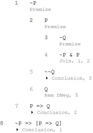

Using a form of natural deduction, if you assume proposition $P$ is false (line 1 below), you can prove that $P\implies Q$ for any proposition $Q$ (line 7). Note that we would not be able to infer anything about the truth value of $Q$ here.
I make use of proof contradiction (line 5), direct proof (lines 7 and 8), and removing double negation (line 6). (Screenshot from my proof checker)
