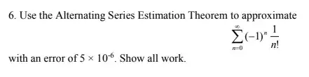

Here is the question:
Here is my work:
I substituted from n = 0 to n = 9 So, I got 1, -1, 0.5, -0.166, 0.0416, -0.0083, 0.00138, -0.000198, 0.0000248, -0.0000027. Then, I added all these numbers together and got $$\frac{16687}{45360}$$ Once, I got that number, I set up my interval, which was: $$\frac{16687}{45360} < S < \frac{16687}{45360} + 0.000005$$
That's my answer. Did I do it correctly or was I supposed to get an exact number?
