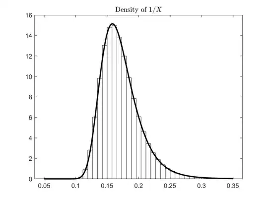

Consider the case $\mu=6$, $\sigma=1$, and $n=1$ so that $\bar X_n=X\sim\mathcal N(\mu,\sigma^2)$. I simulated $X$ in MATLAB with the following code:
mu = 6;
sigma = 1;
Y = 1./normrnd(mu,sigma,1e8,1);
EY = sqrt(2)/sigmadawson(mu/(sqrt(2)sigma)); [EY 1/mu mean(Y)]
EY2 = sqrt(2)mu/sigma^3dawson(mu/(sqrt(2)*sigma))-1/sigma^2; [EY2 1/mu^2 mean(Y.^2)]
EY3 = (sqrt(2)(mu^2-sigma^2)dawson(mu/(sqrt(2)sigma))-musigma)/(2*sigma^5); [EY3 1/mu^3 mean(Y.^3)]
VarY = EY2-(EY)^2; [VarY sigma^2/mu^4 var(Y)]
fY = @(y) normpdf(1./y,mu,sigma)./y.^2; ax = linspace(0.05,0.35,512);
figure hold on; histogram(Y,linspace(0.05,0.35,40),'Normalization','pdf') plot(ax,fY(ax),'Color',[0 0 0],'LineWidth',2)
Here are the results showing that the generalized moments more accurately reflect the sample statistics.
$$ \begin{array}{cccc} &\text{generalized} &\text{delta} &\text{sample}\\ \mathrm EX^{-1} &0.1718 &0.1667 &0.1718 \\ \mathrm EX^{-2} &0.0305 &0.0278 &0.0305 \\ \mathrm EX^{-3} &0.0056 &0.0046 &0.0056 \\ \mathrm{Var}X^{-1} &0.0010 &0.0008 &0.0010 \end{array} $$
