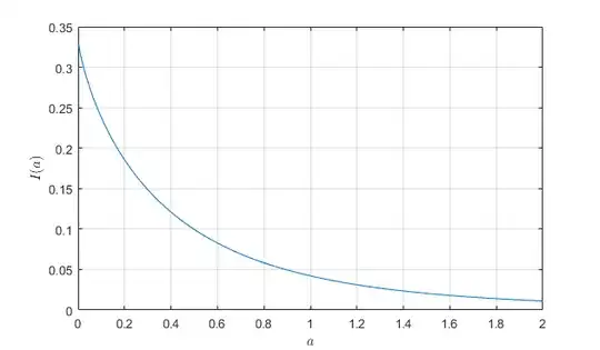

I don't know if this could help, but following is the graph I obtain numerically. enter image description here
Also, taking a look at Gradshteyn and Ryzhik (edition 8), no interesting formula seems to be proposed. Except for formula 6.626 (page 711), where it's mentioned that it applies only for $a > 1$. However, the numerical computation shows that the integral does converge for all $a$ as shown in the graph above.
