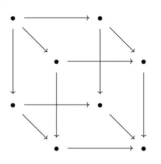

Less concretely, this computation looks nicest with "2D algebra" because it's really a computation happening inside a 2-category. In general, computations inside n-categories are best represented with "n-dimensional operations". For instance, when we draw commutative diagrams, we often have "higher dimensional" homotopies witnessing the commutativity. So we may have a cube like this, which you should think of as just the vertices and edges (that is, just the 0 and 1 dimensional structure)
a cube
then knowing that the faces commute amounts to "filling in" the faces with 2d-squares, and showing that the whole box commutes fills in the resulting (hollow) cube with a 3d cell.
These kinds of arguments are all "higher dimensional" and this really is their natural setting.
