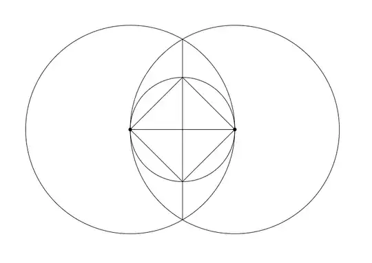

My method for constructing the square in 9 moves is as follows:
  1. Draw circles from each point to the other, and the connecting line
  2. Use the intersections of the circles' edges to drawn a line perpendicular to the first
  3. Draw a smaller circle with its center at the intersection of the two lines and its edge touching the two root nodes.
  4. Connect the four points on the small circle's edge to form a square.
The end result looks like this:
I can't find a way to refine this method to get to eight moves, and I've failed at finding another method. Is it even possible?

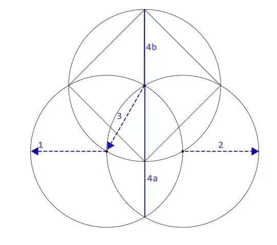

Your solution fails because you give up a move creating the center point of your bounding circle. To complete the challenge in eight moves, you need to use one of the preexisting intersections as your center point, and then rely on the fact that extending a line is not considered a move to create the fourth vertex of the square.
The following diagram illustrates these steps, where step 4b is the non-move extension of the line:
square in bounded circle in eight moves
