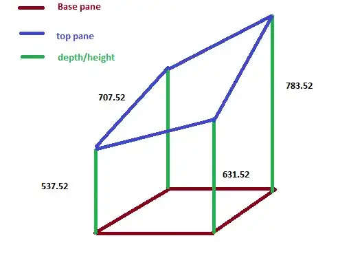

Hi, I am giving here my main problem definition. I have a grid with size $200 \times 200$ and the depth at each point is given in array. For $2 \times 4$ grid, below is the depth level.
And i need to find volume of such solid.
537.52, 707.52, 742.52, 719.52, 654.52
631.52, 783.52, 795.52, 764.52, 727.52
597.52, 868.52, 846.52, 793.52, 707.52
In Image i have tried to plot first grid cell.
Any help/pointer/suggestion would be real help.
I found some post related to this. But not sure which will give best result. http://tutorial.math.lamar.edu/Classes/CalcI/MoreVolume.aspx (Example 2) and link 2 answers.yahoo.com/question/index?qid=20080804220134AA8skGw
Please comment your views. Thanks a lot in advance.

    Is the "top" supposed to be a single flat (but tilted) quadrilateral? (The figure would be a truncated right-rectangular prism.) If so, then the "depths" to opposite corners of the base must add-up to the same value. This does not happen with your sample points: $30 + 80 \neq 0 + 120$. If you're allowing that the "top" might be sub-divided into triangles, then you really want the formula for the volume of a truncated right-triangular prism. – Blue Jul 08 '13 at 13:25

The question statement suggests that OP wants the formula for the volume of a truncated right-rectangular (actually -square) prism; however, the sample data doesn't fit this situation. ("Depths" to opposite vertices must sum to the same value, but $30+80 \neq 0 + 120$.) If we allow the table-top to have one or more creases, then OP can subdivide the square prism into triangular ones and use the formula
$$V = \frac{1}{3} A\;(a+b+c)$$
where $A$ is the volume of the triangular base, and $a$, $b$, $c$ are depths to each vertex of the base.
If the table-top really is supposed to be flat ...
Let the base $\square ABCD$ have edge length $s$, and let the depths to the vertices be $a$, $b$, $c$, $d$; let $h$ be the common sum of opposite depths: $h := a+c=b+d$. Then,
$$V = \frac{1}{2} s^2h$$
This follows from the triangular formula, but also from the fact that you can fit such a prism together with its mirror image to make a complete (non-truncated) right prism with parallel square bases. The volume of that figure $s^2h$ is twice as big as we want, because the figure contains two copies of our target.
Edit. OP comments below that the top isn't necessarily flat, and notes elsewhere that only an approximation is expected. So, let's explore the subdivided prism scenario:
As above, our base $\square ABCD$ has side $s$, and the depths to the vertices are $a$, $b$, $c$, $d$. Let $V_A$ be the volume of the truncated triangular prism over right-triangular base $\triangle BCD$; likewise, $V_B$, $V_C$, $V_D$. Then, by the triangular prism volume formula above ...
$$ V_A = \frac{1}{3} \cdot \frac{1}{2} s^2 \cdot \left(b+c+d\right) = \frac{1}{6} s^2 \left(b+c+d \right) $$ $$ V_B = \frac{1}{6} s^2 \left(a+c+d \right) \qquad V_C = \frac{1}{6} s^2 \left(a+b+d \right) \qquad V_D = \frac{1}{6} s^2 \left(a+b+c \right) $$
Now, $V_A+V_C$ is the volume of the figure where we assume the top is formed by two triangles that meet at a "crease" above diagonal $BD$; and $V_B+V_D$ is the volume when the crease appears above diagonal $AC$. (Note that one of the creases will be a "valley", and one a "ridge".) The desired volume is perhaps somewhere in between, so why not take an average?
$$V = \frac{1}{2}\left( \; (V_A+V_C) + (V_B+V_D) \; \right) = \frac{1}{12}s^2 \left( 3a+3b+3c+3d \right) = \frac{1}{4}s^2 \left( a+b+c+d \right)$$
By the way, we can get the same approximation this way: introduce a new point above the square's center, with a depth equal to the average of the depths at the vertices. Connecting that new point to the vertices creates a "fan" of triangles that approximate the top surface, and each of these triangles hovers over a quarter-square triangular base. The sum of the four triangular solids is the same as our final $V$ above.

  • No, my object is not truncated rectangular. It has square base but varies in height. Something like shown in this picturr http://imgur.com/nS322jz. If you can give any suggestion on how to calculate volume of such object, it will be highly appreciable. – user1211476 Jul 08 '13 at 15:55
  • @user1211476: That's a truncated right-rectangular prism. The slanted plane is doing the "truncating". – Blue Jul 08 '13 at 16:56

From your various comments, I understand that your solid is defined by eight corners, that five sides will be flat but the top side may not, and that you are looking for an approximate solution without worrying too much about the exact shape to the top face.
One viable solution for you might be the following: if the base is a square of edge length $s$, and your heights are $h_1$ through $h_4$, then you can compute the volume as
$$V\approx s^2\frac{h_1+h_2+h_3+h_4}{4}$$
This formula will give you an exact result for the case where the top side is planar. If it is not planar, then this is probably still the best you can get without further information about the actual shape of your top surface.

  • Hi MvG, thankyou very much for reply. But it is not tetrahedron. you can assume like it like a cube with different height. so it has square base and all other 5 side is a trapezoid. and if one of the height is 0 then 3 trapezoid and 2 triangle. I hope I am clear with requirement. Thanks again in advance. – user1211476 Jul 08 '13 at 13:07
  • @user1211476: Your description is incomplete. The diagonals between your four corners to not meet in a single point. So the top face cannot be flat. If you want to split it into two triangles, you have two possible ways of doing so, one along each diagonal. By the way, the volume computed above corresponds to the difference between these two solutions. The fact that it its non-zero indicates that the four points are not coplanar. – MvG Jul 08 '13 at 13:15

    @user1211476: Not much clearer, no. The lilac quadrilateral on top looks flat, since no subdivision into triangles is visible. But as I stated above, and as Blue stated in both his comment and his answer, for the numbers you gave us the top quadrilateral cannot be flat. So the image does not fit your numbers. – MvG Jul 08 '13 at 16:10
  • I know, top pane is not flat, you can imagine it as a solid rock with base as square. I think i wont get exact volume but near by exact, using sum calculas/integral. As per my knowledge goes, there are two ways to get volume. Either use formula of cross section, use integral for base area and varies from 0 to max height. Or some how divide given pane into known geometric figure. I am stuck/confuse and dont know how to go ahead with this. if you can throw some light, may be i can proceed. – user1211476 Jul 09 '13 at 10:21
