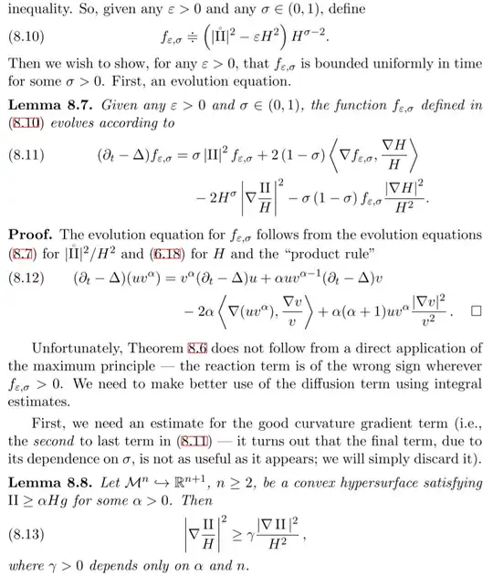

The proof of Huisken's theorem uses a uniform bound on the following quantity. $$ f_{\sigma,\epsilon} = \left(|A - \frac1nHg|^2-\epsilon H^2\right)H^{2-\sigma} $$ for some $\sigma\in (0,1)$ and all $\epsilon>0$. This is done by computing the evolution of $f_{\sigma, \epsilon}$, estimating some of the terms, and then using the maximum principle.

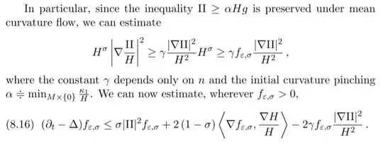

I am confused about the following inequality in p.294 of Extrinsic Geometric Flows by Andrews et. al: $$ \gamma \frac{|\nabla A|^2}{H^2}H^\sigma\geq \gamma f_{\sigma,\epsilon}\frac{|\nabla A|^2}{H^2} \tag{1} $$ This implies that $H^\sigma\geq f_{\sigma,\epsilon}$ since $\gamma>0$ and $H>0$. However, using $|A|^2\leq H^2$, the best inequality I can get is \begin{align*} \frac{f_{\sigma,\epsilon}}{H^\sigma} = \frac{|A|^2}{H^2}+1-\frac{2}{n}-\epsilon\leq 2-\frac{2}{n}-\epsilon\,. \end{align*} In fact, using uniform convexity $A\geq \alpha Hg$, we have $$ \frac{f_{\sigma,\epsilon}}{H^\sigma} =\frac{|A|^2}{H^2}+1-\frac{2}{n}-\epsilon\geq \alpha + 1-\frac{2}{n}-\epsilon $$ so for large $\alpha$ we would have $f_{\sigma,\epsilon}\geq H^\sigma$. What am I missing here?
I have added an excerpt from the book below.
Context: one of the terms in the evolution equation for $f_{\sigma, \epsilon}$ is $$-2H^\sigma|\nabla\frac{A}{H}|^2$$ Then, in p.294 they show that if $A\geq \alpha Hg$ for $\alpha>0$, then $$ |\nabla\frac{A}{H}|^2\geq \gamma\frac{|\nabla A|^2}{H^2} $$
where $\gamma$ depends on $\alpha$ and $n$. Since $A\geq \alpha Hg$ is preserved under mean curvature flow, the above inequality holds for as long as the flow exists with the same constant $\gamma$. This leads to the left side of (1).
