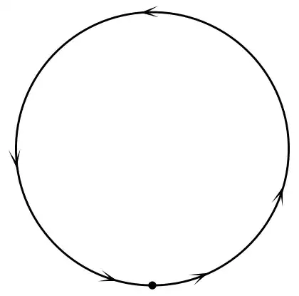

Here is a humble graph: https://www.desmos.com/calculator/tgrhizoot6. It's also useful to have the phase portrait in mind; it looks like this:
(I've taken this image from Hasselblatt & Katok's A First Course in Dynamics, p.130. Note the resemblance to the projective action of shear matrices; indeed horocycle flows are also uniquely ergodic and unique ergodicity is a topological property (see Topological Invariance of Unique Ergodicity for the latter statement).)
