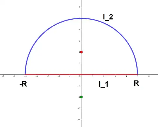

Define ($R > 2$) $$2\pi i\ \hbox{res}_{2i} f(z) = \int_{C} \dfrac{\cos(z)}{(z^2 + 4)^2} \ dz = \int_{red\ I_1} \dfrac{\cos(z)}{(z^2 + 4)^2} \ dz + \int_{blue\ I_2} \dfrac{\cos(z)}{(z^2 + 4)^2} \ dz $$
Repare that $$\int_{red\ I_1} \dfrac{\cos(z)}{(z^2 + 4)^2} \ dz = \int_{-R}^{R} \dfrac{\cos(x)}{(x^2 + 4)^2} \ dx$$
$$\lim\limits_{R \rightarrow \infty} \int_{-R}^{R} \dfrac{\cos(x)}{(x^2 + 4)^2} \ dx = \int_{-\infty}^{\infty} \dfrac{\cos(x)}{(x^2 + 4)^2} \ dx $$
and
$$\lim\limits_{R \rightarrow \infty} \int_{blue\ I_2} \dfrac{\cos(z)}{(z^2 + 4)^2} \ dz \leq \lim\limits_{R \rightarrow \infty} \pi R M = \lim\limits_{R \rightarrow \infty} O(1/R^3) = 0$$
where $M = max\left\{\left|\dfrac{\cos(z)}{(z^2 + 4)^2}\right|, z = Re^{\theta i} (0 \leq \theta \leq \pi) \right\}$ (I use $|\int_{C} f(z) \ dz| \leq \int_{C} |f(z)| \ dz$)
So
$$\int_{-\infty}^{\infty} \dfrac{\cos(x)}{(x^2 + 4)^2} \ dx = \int_{C} \dfrac{\cos(z)}{(z^2 + 4)^2} \ dz = 2\pi i\ \hbox{res}_{2i} f(z) = \dfrac{3\pi}{4^2e^2} $$
    Your $M$ is unbounded as a function of $R$, because $\cos z$ grows exponentially along the imaginary axis. The standard fix is to compute the integral as the real part of $\displaystyle\int_\mathbb{R} \frac{e^{ix}}{(x^2+4)^2} , dx$, and apply Jordan's lemma. – Micah Feb 14 '22 at 02:55
